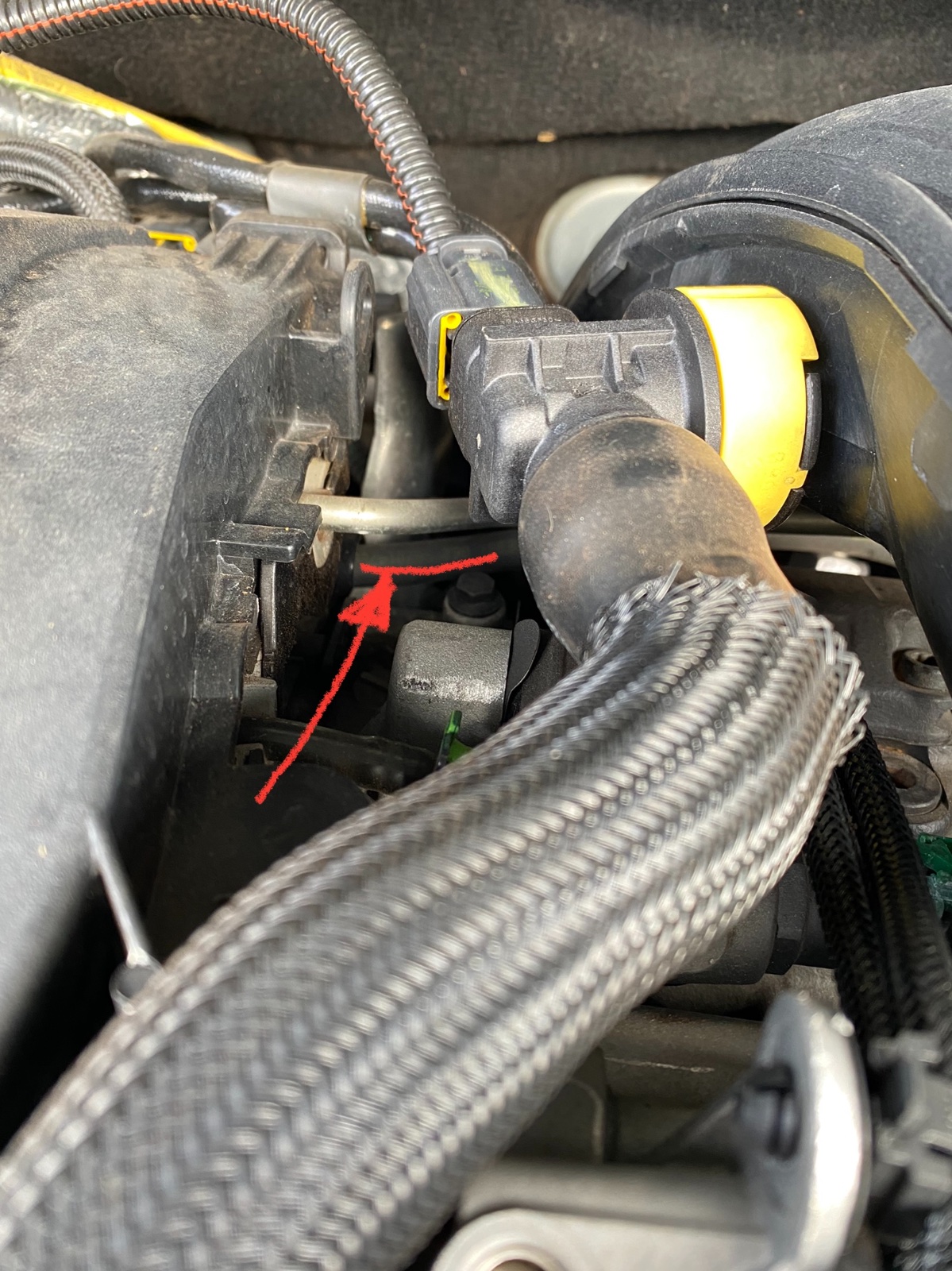

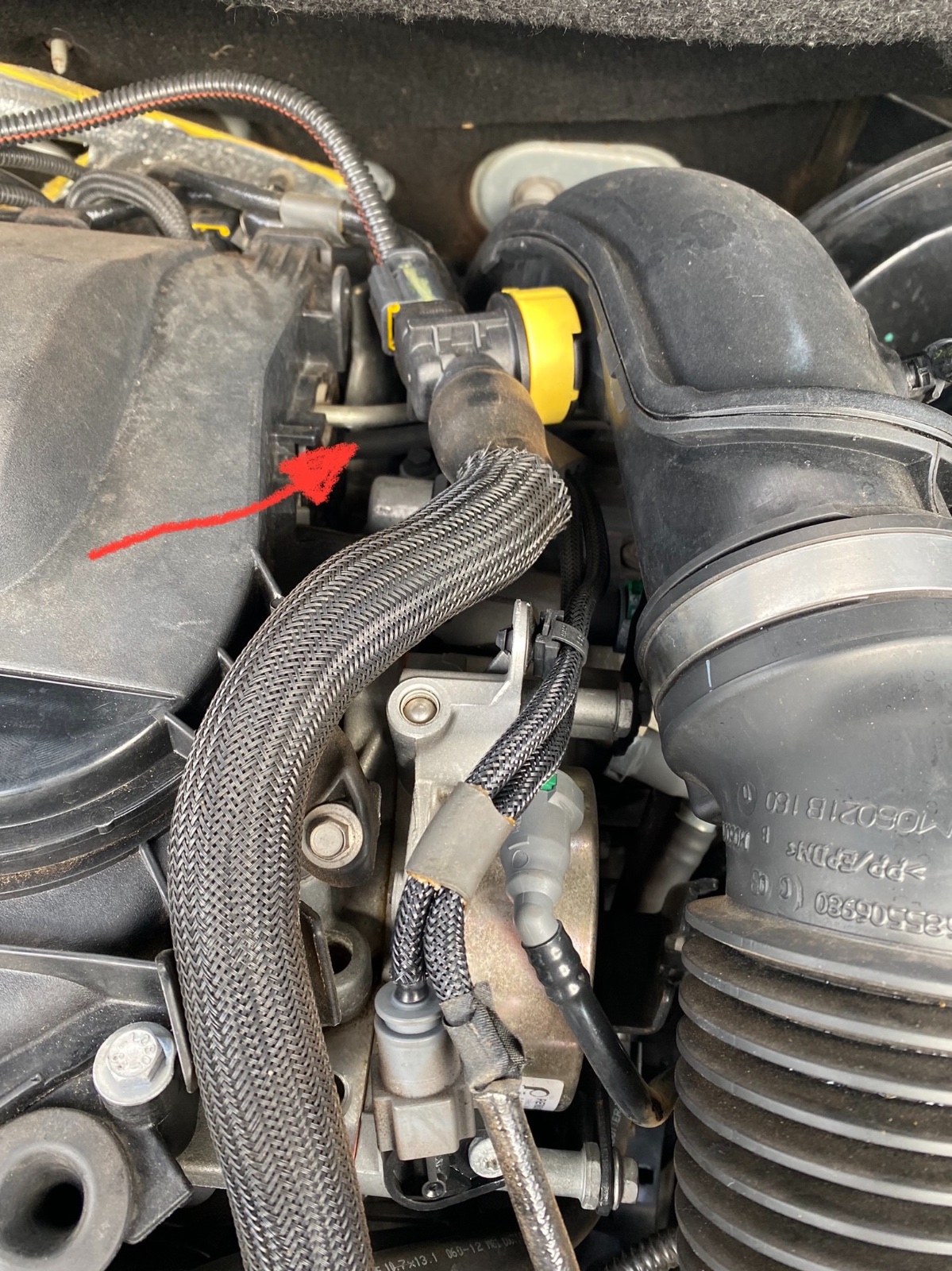

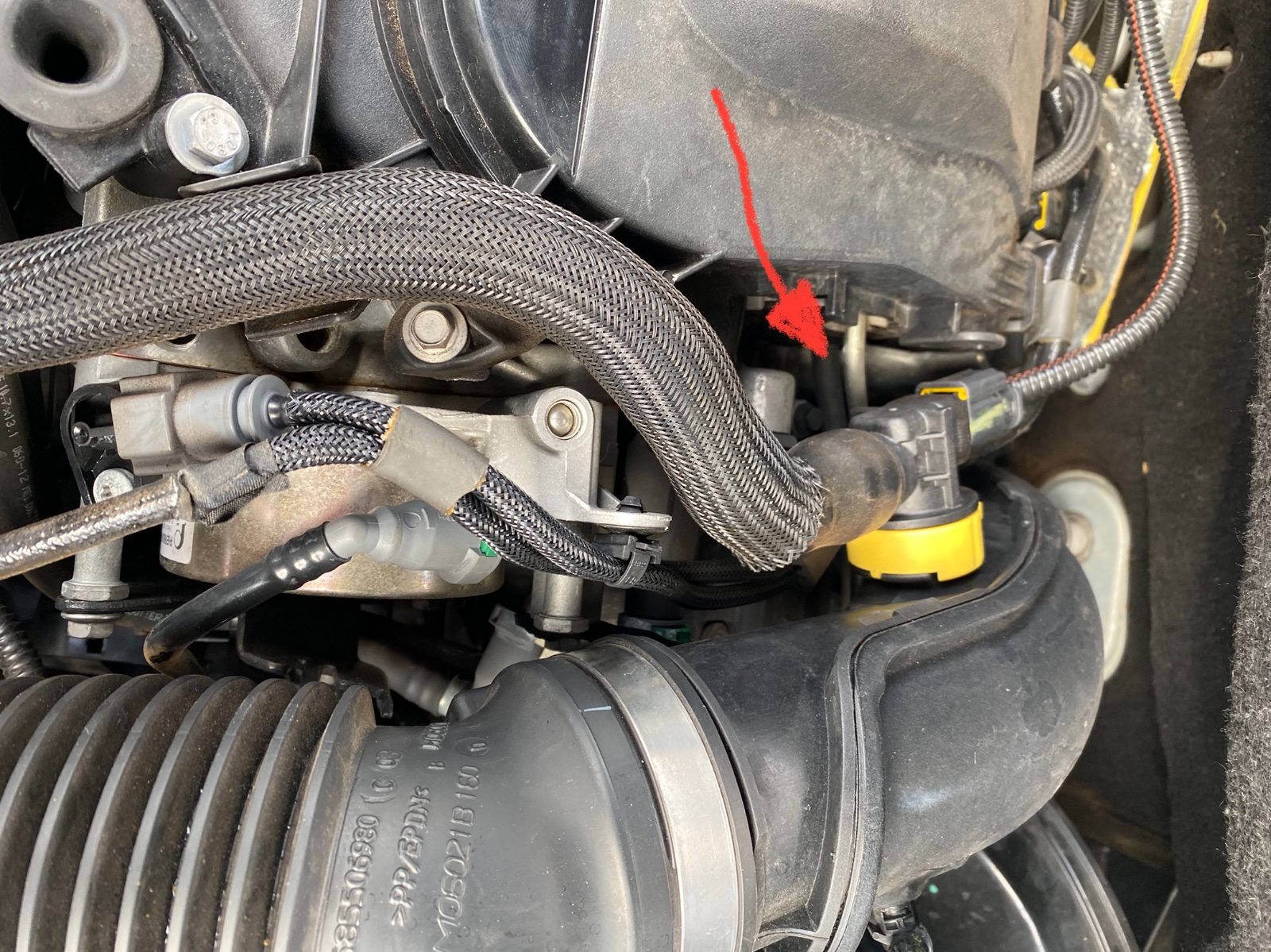

Hi I have problem locating the other end of hose (vacuum ?) on my attached photo.
Can anyone help, please?

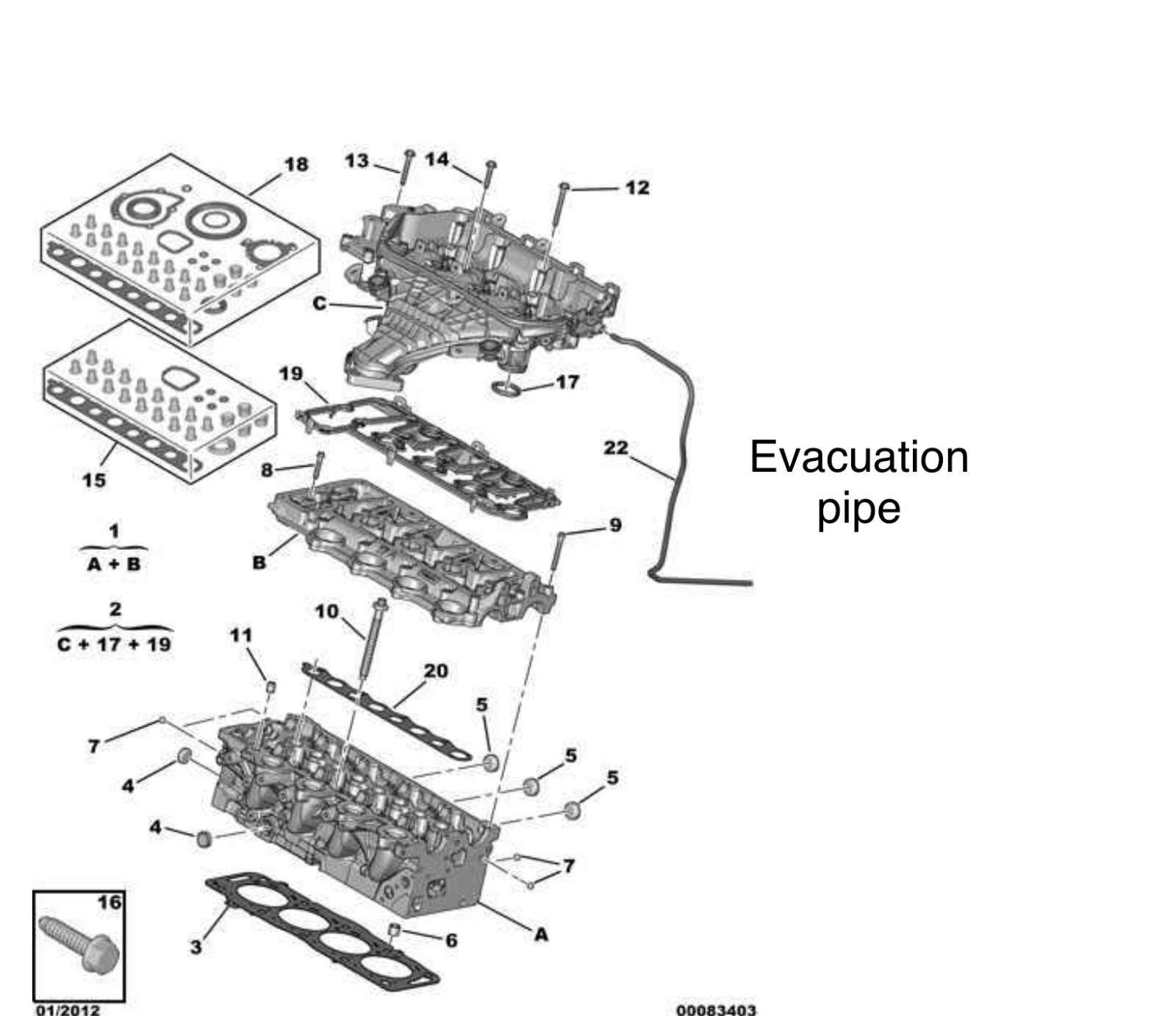

I believe it is “ evacuation pipe”
Does that mean it is just hanging down on the side and does not connect to anything ?

I suspect it is - there's nothing specific on this, so I would ignore it.
