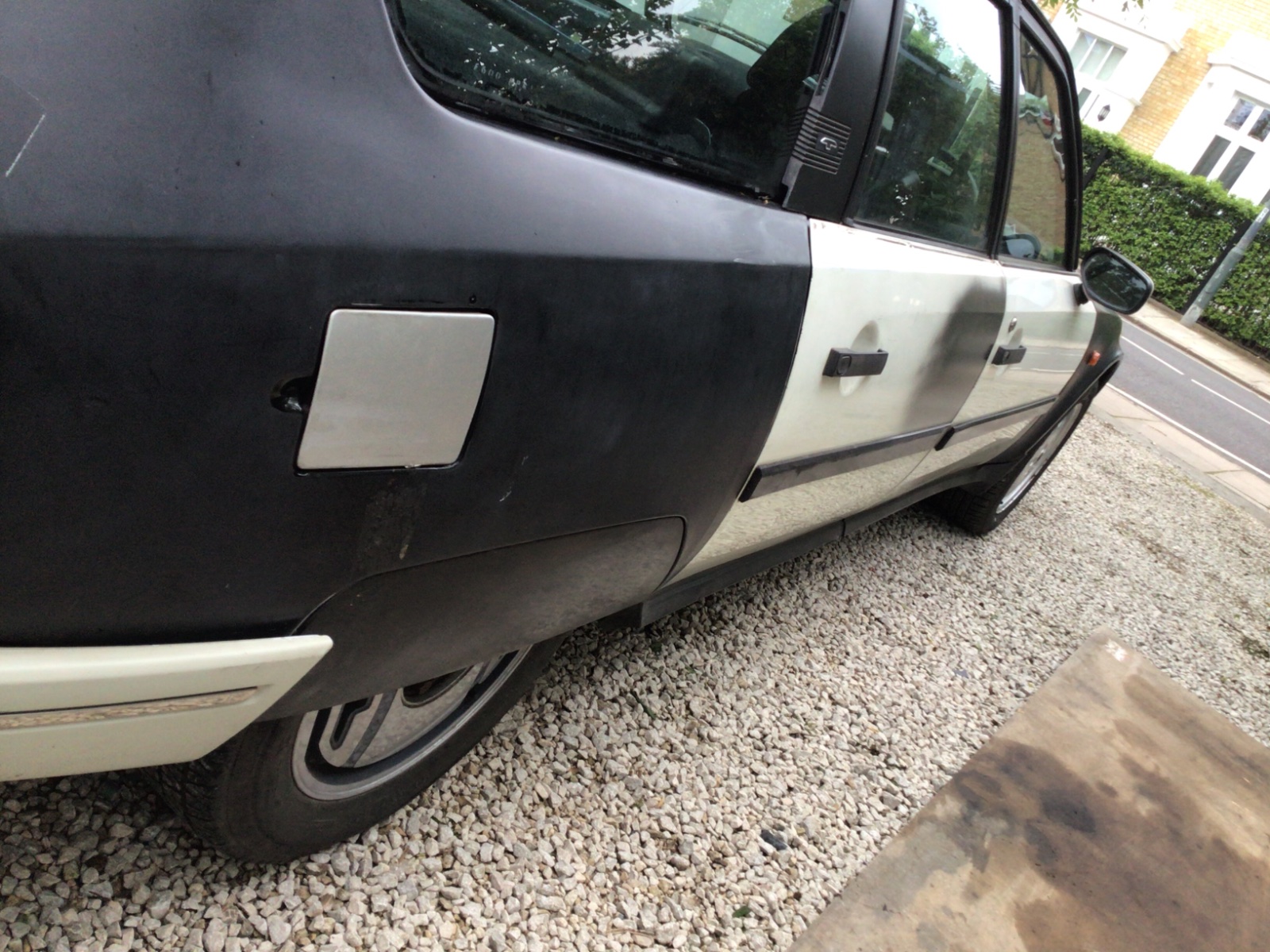

I’ve also been hard at work on the exterior appearance as the car is booked in for paint in about 5weeks!!!!
So, brand new bootlid, and very good bonnet and 4 very good ‘Turbo’ doors with all the correct trim, etc and working electric windows and central locking.

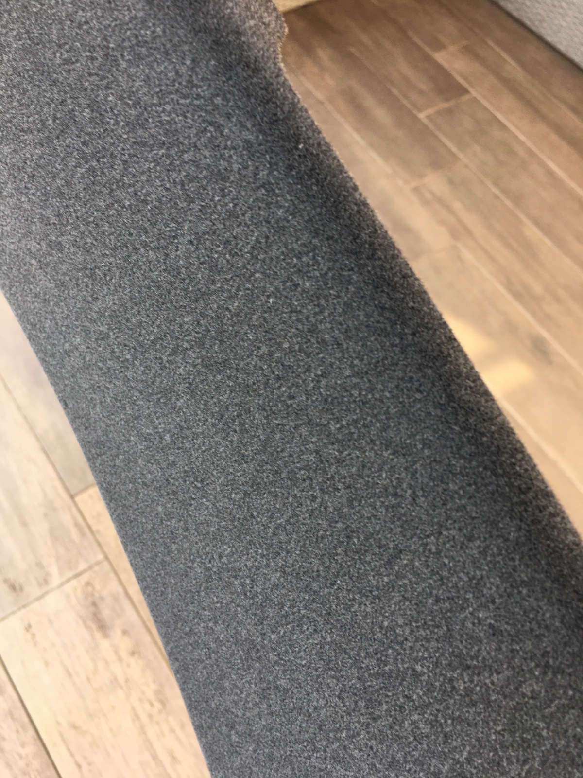

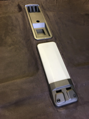

Lots and lots of progress. I’ve redone the headlining and had the A,B,C and other interior trim pieces ‘flocked’, the results are STUNNING!

Tell us about the flocking - who, where, cost?
