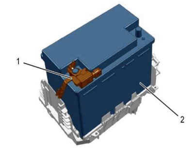

Ah, that's my Economy mode fix I see... it can help resolve the power cutting out just when you need it as in the case above - but it is important that you do maintain and check the condition of your battery in this case. I take mine off and do a maintenance charge on mine every 3-4 months - as I don't do the miles on it and use the C3 for local trips.
This keeps it conditioned and topped up.

Urrrrrrm.
How does one know if ones C5 (2008 2ltr Hdi Tourer Exclusive (Power tailgate)) is fitted with this Battery monitoring unit? Can the BSI be reconfigured Per this mod using any other professional diagnostic box?
Thanks.

Re: C5 X7 tailgate anger......
You do have one Checked against your VIN, item 1.
I doubt most aftermarket units will be able to do it - as it's a non-standard function / programming function.
