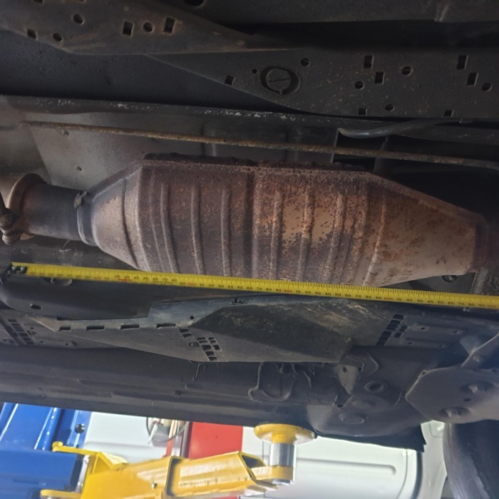

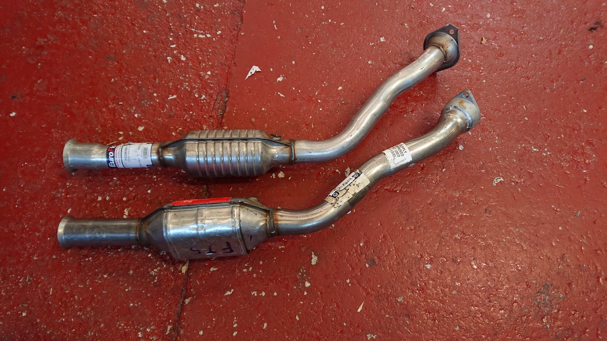

OK the motor factors has ordered in the two options above. They both match the Citroen OE part number 1731 41
This is the one currently on the car:
These are the two options from the motor factors:
Neither look like the original, but maybe still compatible?
Ideas welcome

The after-market converters available for Xantias all seem to be smaller than the originals (the age of the cars means that they don't need EU type approval), but there have been reports that they don't have a long life.

Re: Australian '97 2.0 Xantia needs a new catalytic converter. Need help finding the right part.
I'm glad to hear being smaller isn't a concern - in fact that helps me with shipping.
I'm not too worried about it having a long life as I won't have the car for that long.
Any opinions on which of the to it's likely to be? Or maybe it doesn't matter
