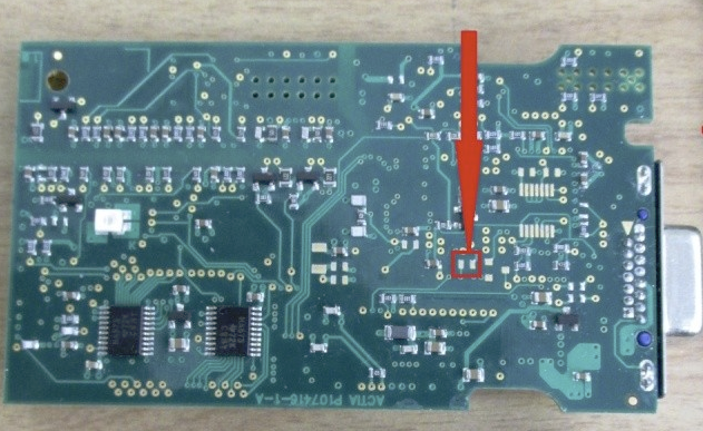

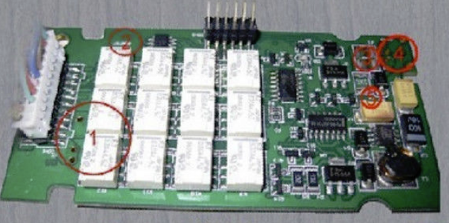

4a) No - just apply the update you want - and I suggest the from 7.** to 7.58 update. However, as I mentioned in my last post - if you have an older revision unit, you may be restricted to 7.02.

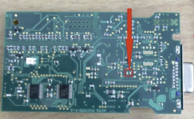

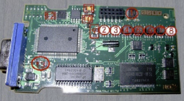

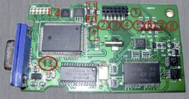

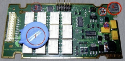

4b) Opening the unit - be very careful as it will void any warranty - but I suspect it is out of date now anyway. Yes you can determine the type of unit:
As you can see the cheaper versions are missing components circled which include Optocouplers........ When compared to a full chip example here
...and again on the other board - missing components......as compared to a full chip kit.
Further on some lesser units, there is a resistor missing arrowed that relates to CAN communication....
Ok, the VIN should be detected - but the DAM number will have to be entered manually - that is normal for both Lexia and PP2000. If it's not picking up the VIN then it's not right. Check that PP2000 is not already launched and hidden on the taskbat - sometimes the interface can obscure PP2000 and you are unaware it has launched but is hidden under the other window - so launching it again causes a problem.

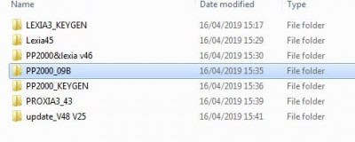

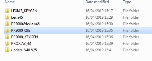

I also have files from a second CD I got with the kit. I can't see that PP2000 is actually installed anywhere. C:\AWROOT contains DiagBox but C:\APPLIC is created but empty?
Dougie.

First I would downgrade to the earliest version you have above the main installation of 7.02.
Next, ignore the files and folders on the CD. The installation of Diagbox actually installs both Lexia and PP2000 as part of the package. These are encapsulated software stored and launched automatically depending on the vehicle being diagnosed.
Normal practice is to select he Marque first, then select the model. Then it will ask you to connect the VCI and should then detect the VIN. It will ask you to confirm the VIN. For cars circa 2007 and earlier it will ask you to launch ‘scantool’ or PP2000. If you select PP2000 this is where it can become hidden underneath the main Diagbox window, so do check the taskbar. Then it should ask for the RPO or DAM (build number).

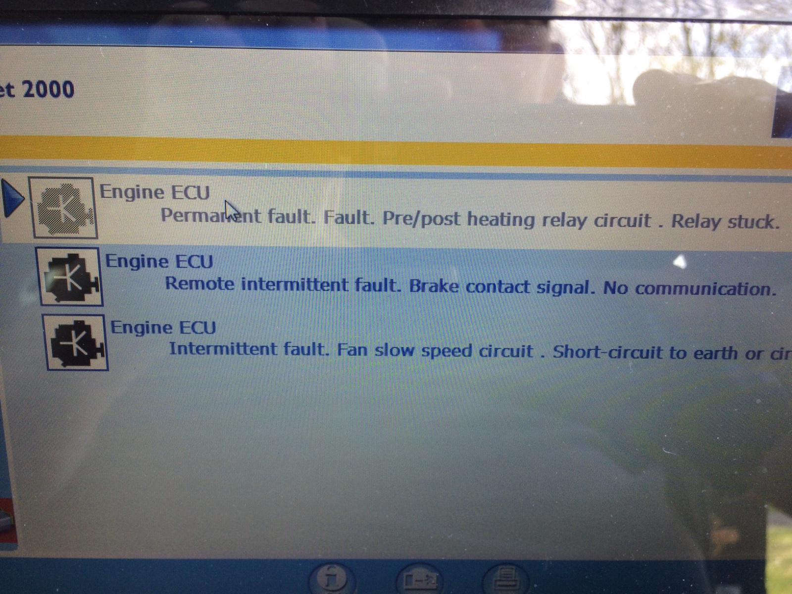

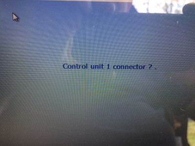

Soooo.... I was unsuccessful in directly downgrading DiagBox so uninstalled it completely including thoroughly checking and cleaning out the Registry. It took two attempts as the first one failed to complete but second time, PP2000 and Lexia also installed correctly. Now I know for sure that PP2000 has been missing on the laptop from when I bought the kit (which may account for it not loading... :roll: ). I also did the lowest-level upgrade from 7.01 to 7.57.
Tried it today, and voila! Proper connection and functioning by PP2000 on all ECUs. =D> So I am of course more than grateful for your time and help on this Marc.
The MIL came on a few days ago and the pics show issues with the engine ECU. I also get the 3-beep warning now even after clearing the codes. The pics below show the faults, the main one appearing to be the pre/post heating relay circuit which shows the further message when selected. The fan does seem to work on slow speed. Any ideas?
Dougie.

Post by GiveMeABreak »
Glad you are up and running now :-D
The first fault re the glow plugs is extremely common on HDIs - normally it gives a message about plugs never been supplied which most generally ignore!
Best make a note, read and clear the faults and then re-run a Global Test to eliminate any historic faults. You can then expand these and deal with them individually.
