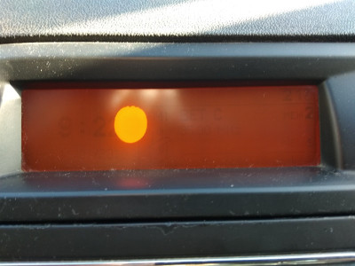

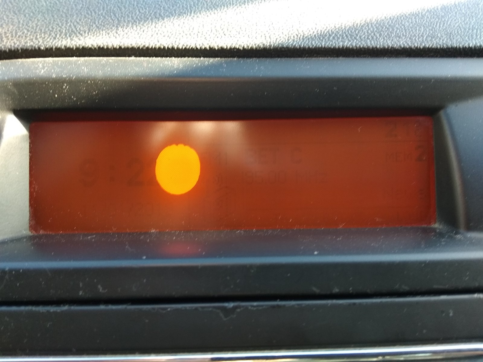

Hi
on my c5 x7 the multifunction display has a problem. there is a bright spot on the middle of it and the info is (very) hardly visible. since I have the mfd from my previous c5 mkii, I would like to know if it's compatible with the one fitted in the x7? pic of the faulty mfd attached. Thanx.

Avi - do we have the VIN of your current X7, as although the X7 with standard display uses the 'Level C' multifunction display, there are a significant number of variations, according to build date, country and options, so I would have to check. I have your old VIN for the MK II, so can do a comparison.

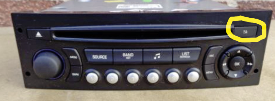

There were 2 options (excluding the navigation models) that utilised Bluetooth. One was the RD4 which had to utilise the Nomad hands free unit that was a separate module to handle calls and secondly this was later replaced with the RD45 unit which had Bluetooth and USB built into the Head unit (not the MFD).
You only have the RD4 basic system in your car, and according to your VIN there is no hands free unit fitted either, although you have the microphone already installed.
So you’ll probably need to do an RD4 to RD45 upgrade if you want hands free Bluetooth calling Avi.

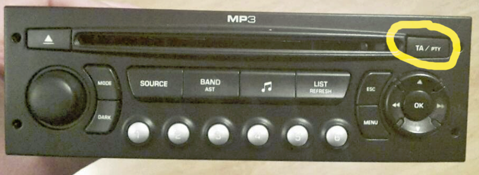

Another way to identify the RD45 unit is that they do not have the PTY marking on the fascia.

Marc - could you pls clarify how the upgrading to the RD45 is done? I guess that some sort of a device is needed. could you elaborate on it?
what is the PTY marking and where it can be seen?

RD4 - Has the TA/PTY | RD45 Does not |

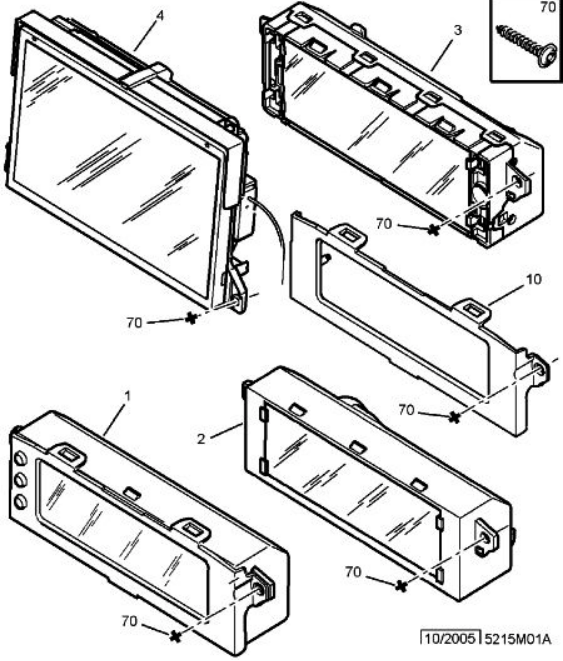

You have to understand that the electronic architecture is different on certain models from certain dates and the compatibility of the ECUs with the BSI as an example. There are of course examples where PSA will use the exact same part number for a Citroen and a Peugeot model and do list identical parts numbers. But they are NOT all the same when the part numbers are different and another reason why we have people coming back with problems afterwards as they have not used the correct display. Peugeot and Citroen also display the vehicle information differently, this is another factor and can affect the vehicle if miss-configured.
Let's take the C5 II as an example; there are 5 available screens, discounting the large colour screen in the diagram that leaves 4. Of these 4, there are 8 variations.
So what are the variations?
- Clock, Temp but without Radio to Dec 2005
- Clock, Temp but with / without Radio Dec 2005 to June 2006
- Clock, Temp but with Radio From June 2006
- Then we have Sept 2005 with no radio and again with radio but with DRLs
- Then we have Radio, Clock, Outside Temp & CD from Sept. 2004 and except China
- Next,Clock, Temp Radio & DRLs April 2005 to March 2006
- Next China only from June 2006
- Then Navigation, Radio, Clock, CD to July 2005
- Then Navigation, Radio, Clock, CD from July 2005
