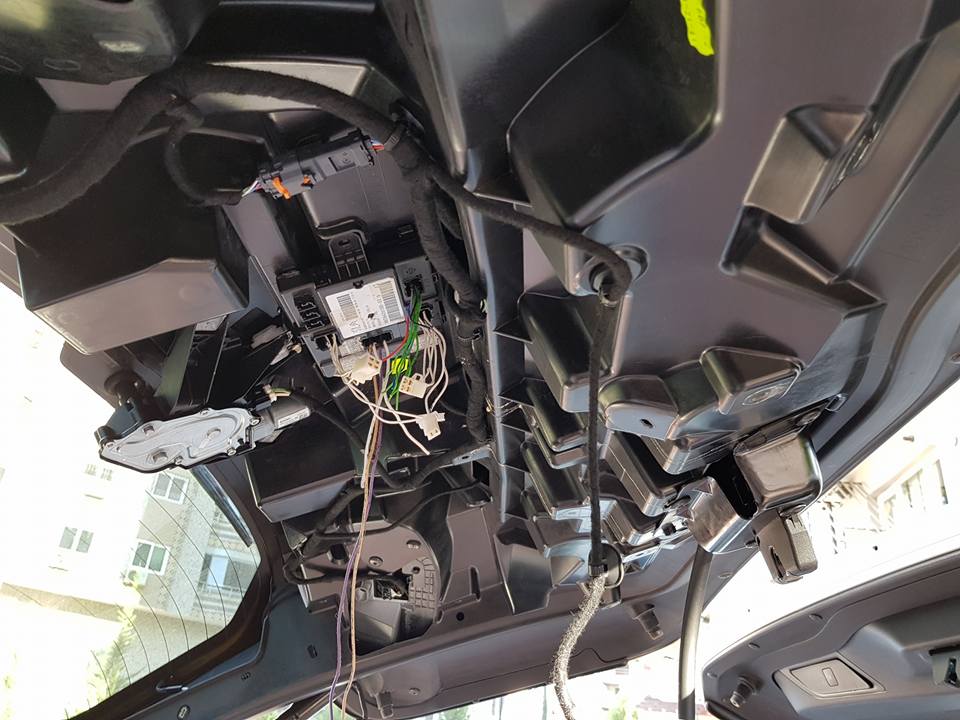

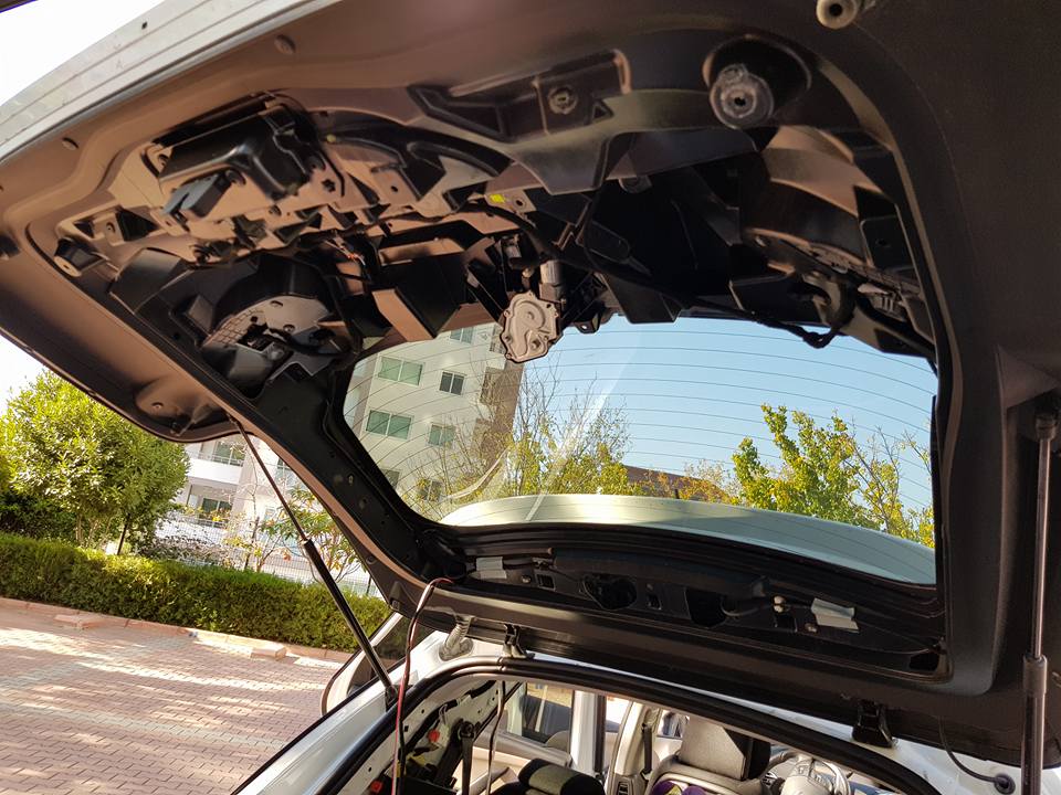

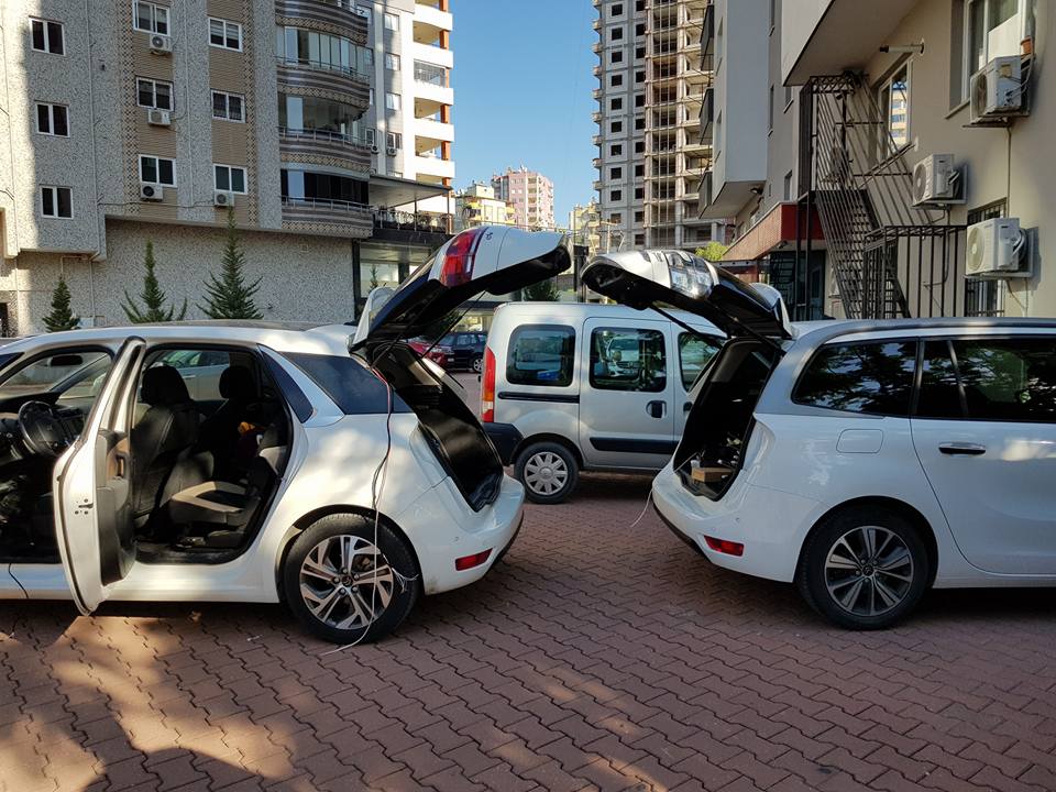

I used old ETG6 gearbox grand picasso and new EAT6 gearbox Citroen C4 Grand Picasso. My first picasso has electric tailgate and when I bought newer picasso it does not have electric tailgate. I bought used parts (struts, tailgate computer, lock mechanism) to my new picasso. I installed successfuly also I installed two cars after my first installation. I added foot trigger opsion to open tailgate without touching open button. Just put your foot to under bumber like new MK2 model!
If you have any question I can help to you or If your car has electric tailgate I can convert tailgate open operation from manual to foot trigger

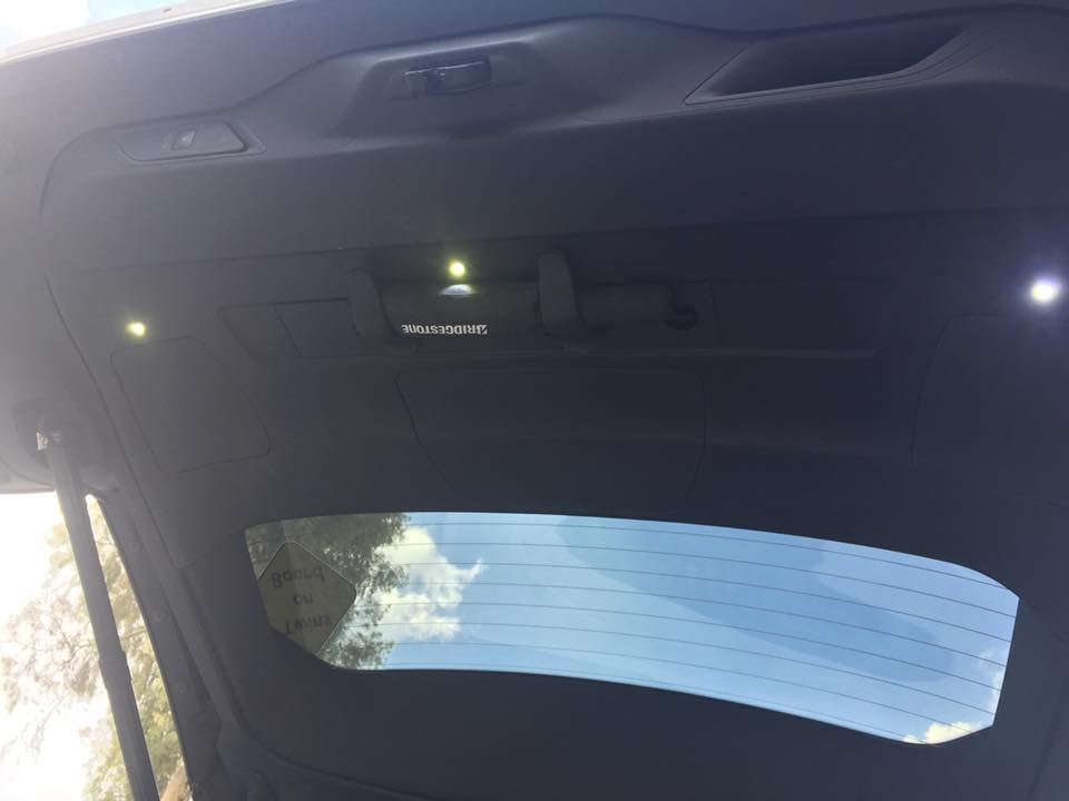

If your car has a foot trigger you have MK2 Picasso. You can add additional lights on boot lid and you can add open / close button on dash board. There is no option open / close inside of cabin.

Re: Citroen C4 Grand Picasso aftermarket electric tailgate with foot trigger operation
Yes estebanfree, it’s a mk2 (2017) and you are right, no internal control for the tailgate.
What ‘additional’ lights do you mean?
Maurice
Maurice
1999 V6 Xantia
- Posts: 8
- Joined: 11 Dec 2017, 07:42
- Location: Turkey
- My Cars: C4 Grand Picasso B78 new shape
you see there were 3 LED (Eagle eye 3W) I added them..

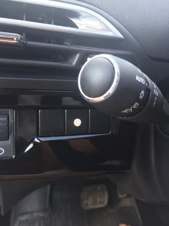

Could you tell me please how you did the cabin button? That would be more useful than the hands free at this point but I would like to add that as well lol
- Posts: 8
- Location: Turkey
RTDM wrote: ↑30 Mar 2019, 20:05estebanfree wrote: ↑18 Mar 2019, 03:57 Yes you can add foot sensor and cabin open / close button. If you need help you can ask any quetion any time..
You can connect tailgate button as parallel
