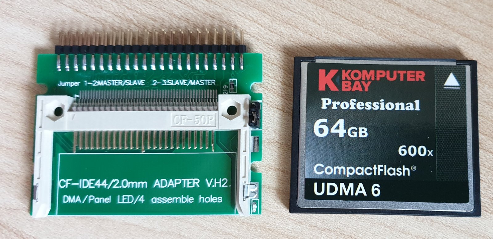

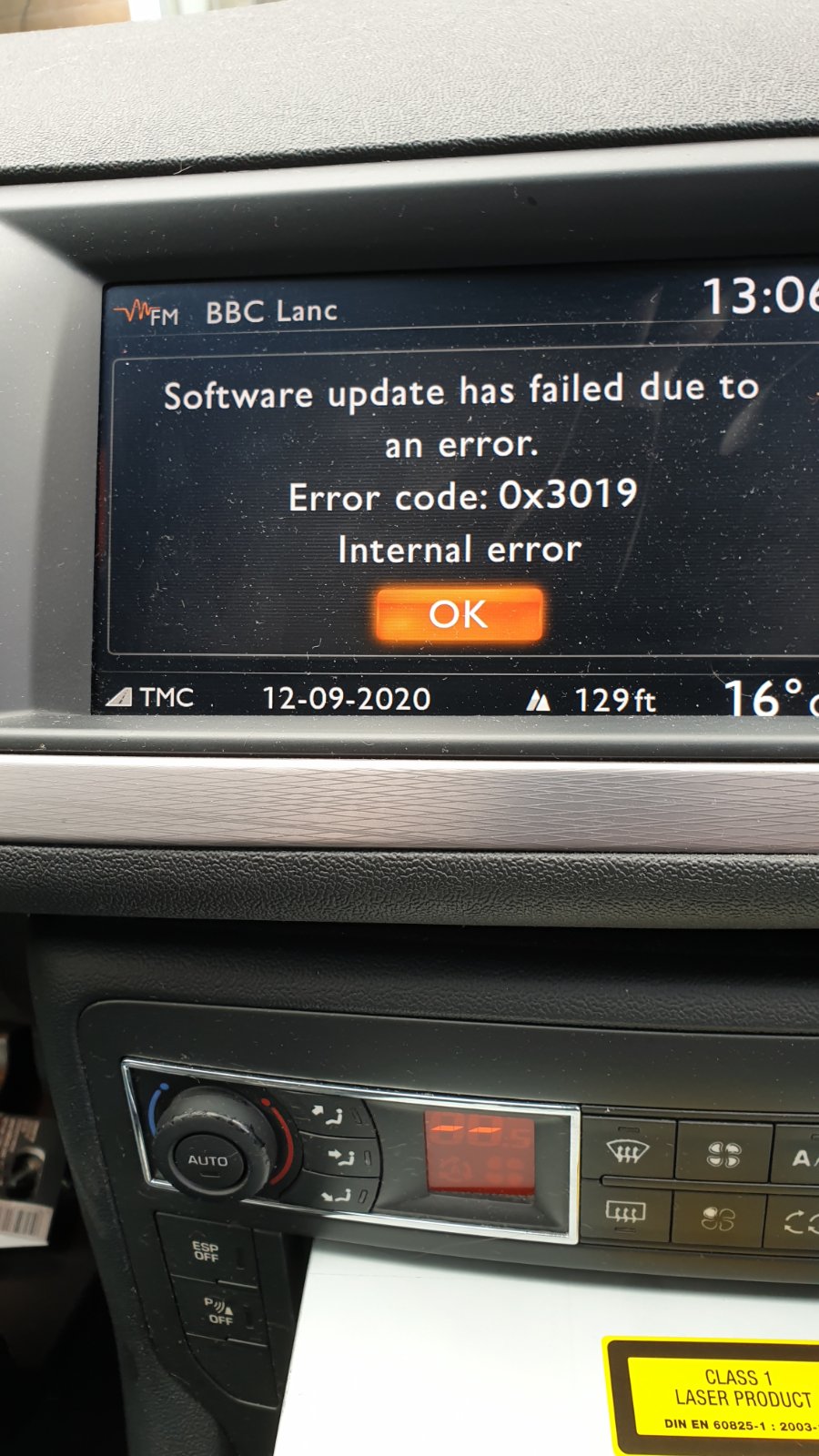

mrhardware wrote: 13 Sep 2020, 11:31 The CF card is the one recommended in the Guide
And this is the error message
Ok, so these are my thoughts:
When the firmware is used to perform a new installation, I believe that a lot of the data is first written to onboard chips in the first stage and then from there to the HDD / CF Card Media.
In this case, it is completing the first part of the installation, but when it comes to the actual writing to the media card it cannot write any data. So this is why when you examine the CF card in Windows you are not finding the partitions - because it cannot write to the media to create them and cannot proceed further, returning the error.
This can be down to the Master / Slave settings of the adaptor interface card, or the actual interface card itself. This is why the PC will be able to write data to it, but not when you use the interface card.
Is your Hard Drive actually knackered or were you just trying to replace it to preserve it?

My HDD is OK but system rebooting more frequently so replacing before it finally dies.
I have refitted the original HDD and the system is back up and working as it should.
The Cf adaptor is defiantly jumpered slave as i was trying to upgrade from CD and if in other position (master) the CD does not read but does when in slave position.
I have been trying to find the original adaptor you used but it looks like is no longer available.

Yes, that's the problem with these adaptors here today, gone tomorrow!
As for the Hard Drive. Typically the restarts are symptomatic of a heat problem. Even with the double DIN sized unit, air circulation can sometimes cause a problem - especially as it is amping the sound too. Thje hard drive should be able to cope with extremes of temperature (automotive grade), but the components themselves are another story.
I've heard others say the restarts are more frequent in warmer months too. I never had the restart issue myself as I always tend to have the cabin colder than most people prefer! But in winter this can become an issue for obvious reasons.
As for the jumper settings, I suggested reversing the jumpers as with these Chinese things - their instructions are not always clear shall we say :roll:

I have managed to get it to work.
I was trying to do a clean install but in the end i imaged my drive that did not show up any errors.
I then imaged back to the CF card and after refit the system worked as it did before.
Thanks Marc for all your help.
