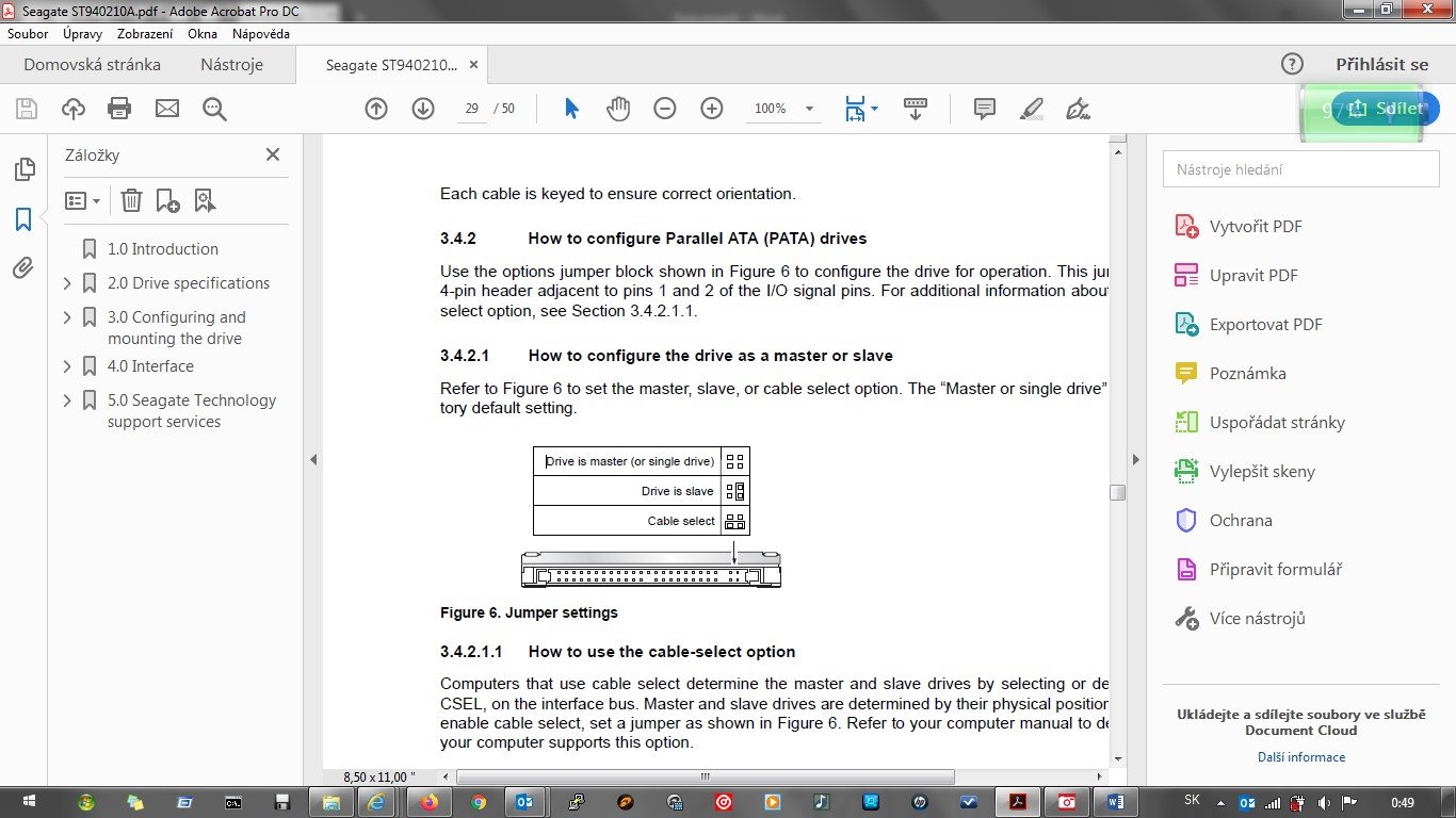

Hello,
(sorry, my english is bad)
My org HDD Thosiba 40GB replace Seagate ST940210A 40GB - working (Seagate setting jumper MASTER)
(clone HDD with Clonezilla to HDD)

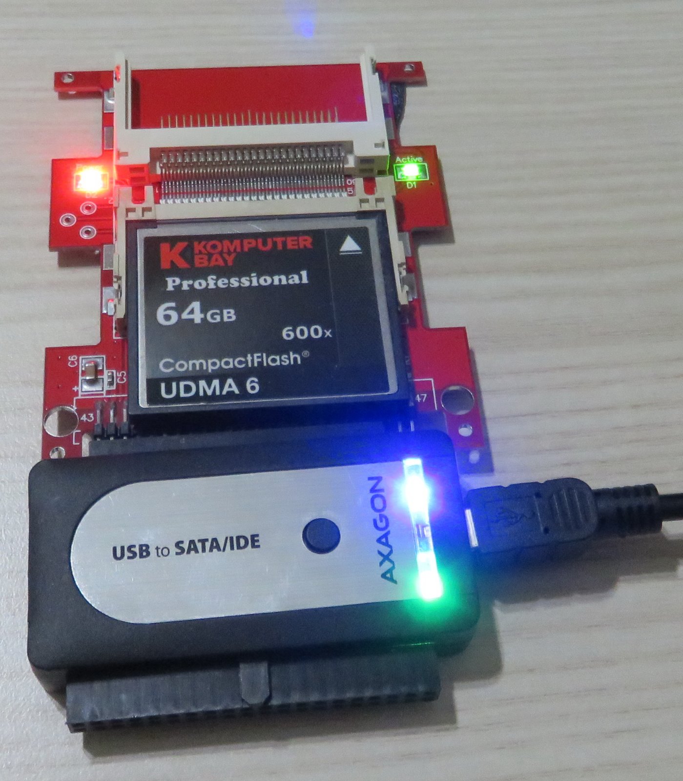

I have CF card - KomputerBay Pro 64GB 600x UDMA6 and 2xCF/IDE adapter - not work
(clone HDD with Clonezilla to CF)

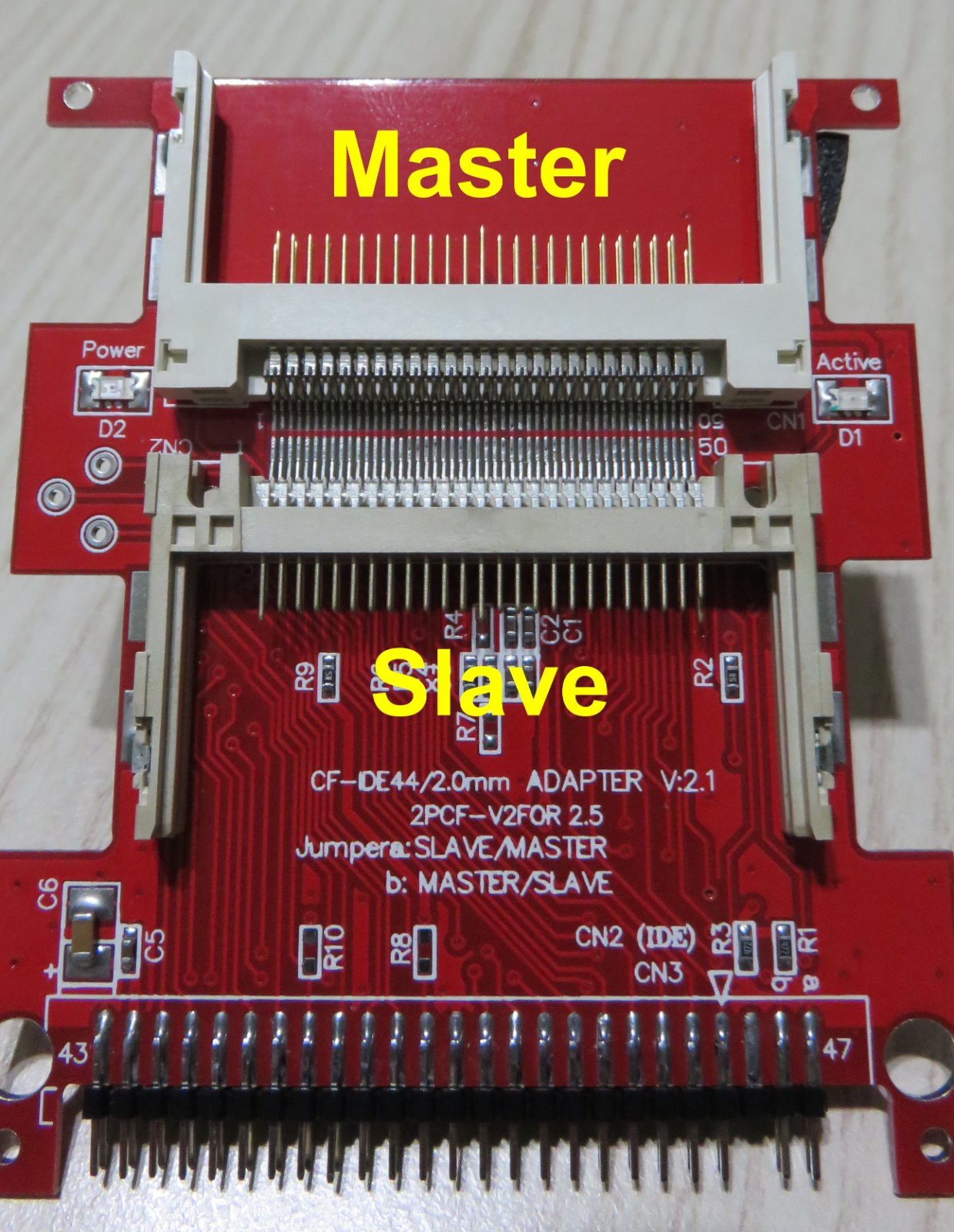

Re: Guide to Replacing the NG4 Navidrive 3D Hard Drive with a CF Card
If I will put 2CF/IDE adapter + CF card in NG4, not work USB and DVD drive
Your firmware - copy in USB and SD card
Firmware on USB key - nothing happened
Firmware on SD card - internal error 0x3019 - 67%

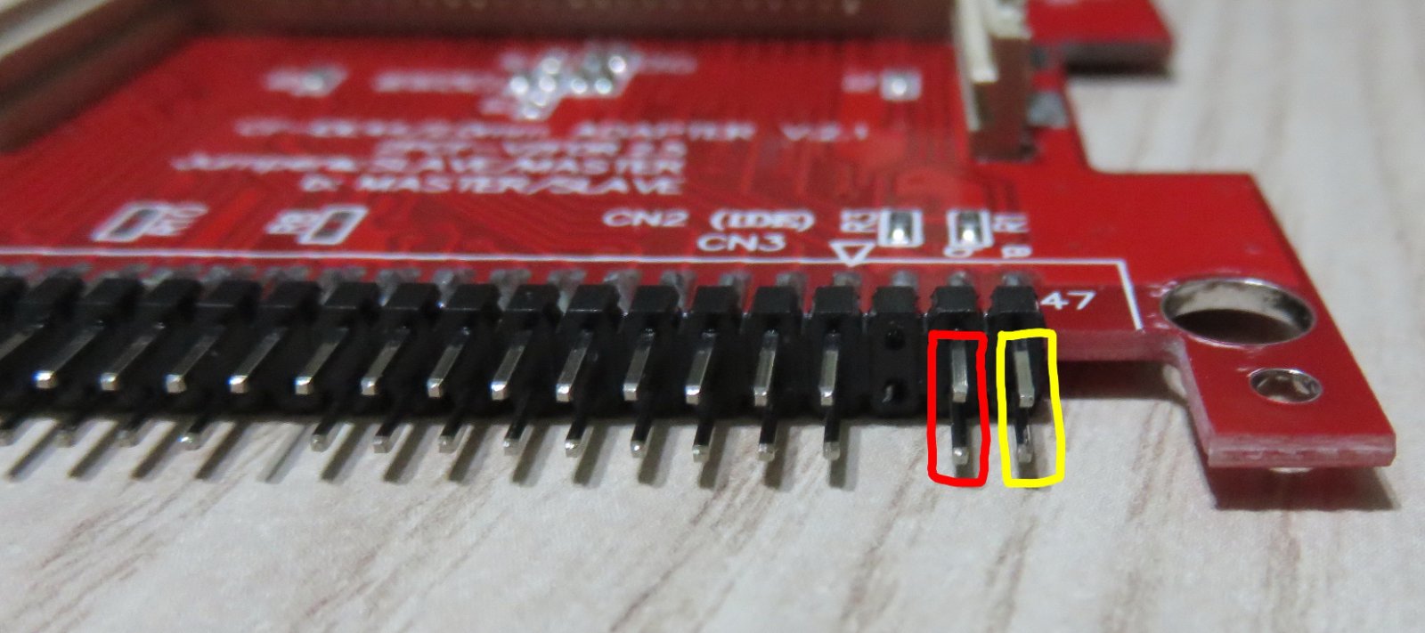

I don't have the nerve (I burn my car, NG4, Garage, Notebook, CF card, Adapter - and I will be happy)
This is adapter is bad, not working CF card in NG4
I understand it correctly
CF slot 1 - master (CN1)
CF slot 2 - slave (CN2)
jumper settings
Yellou - master
Red - slave
soldering this pin? (slave)
I have this adapter - not work
https://www.aliexpress.com/item/3303124 ... 4c4dNcoEUj
This adapter is ok? or?
https://www.aliexpress.com/item/3279503 ... DJrYZ&mp=1
https://www.aliexpress.com/item/3283363 ... 4c4d2Huq1D
