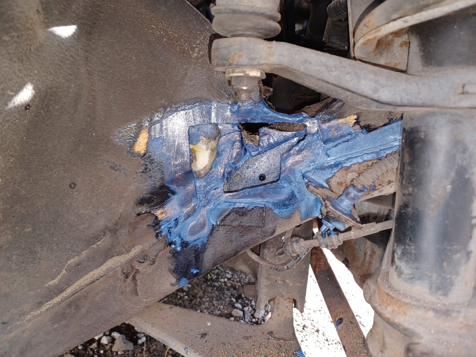

Time to sort out a patch that I have left FAR FAR to long....noticed at the last MoT (was small then) this has grown to twice it size (still only little)
(Below)

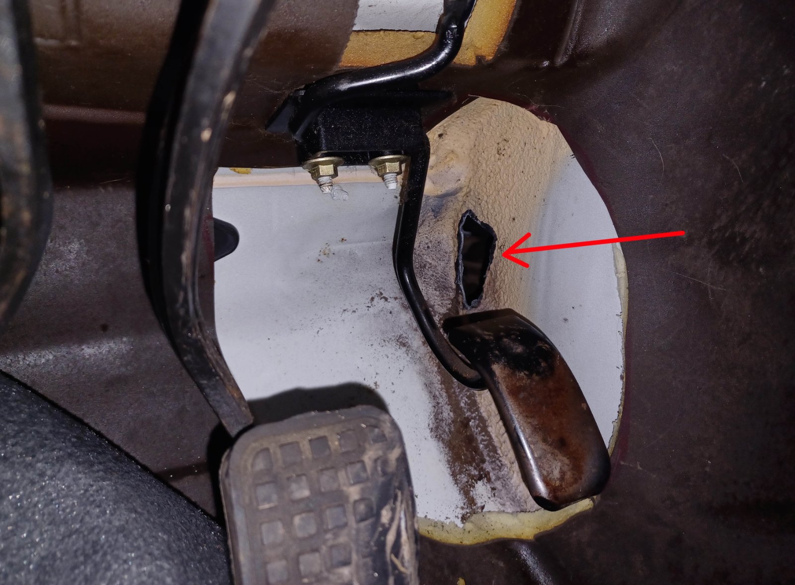

A small patch on the chassis leg has to be done first, where the rot from the outside of the inner wing has penetrated....then a second patch is needed to replace the cut away rotten metal of the inner wing.... (Below)
The inner wing patch also closes the footwell (you can see the carpet foam in the image above) with spot welds onto the upright section (from the bottom left corner up through the T)....so I will need to do some metal beating to get the shape correct. On a AX, no panels fit, they just used massive amounts of seam sealer....it is quite laughable really
Rot all cut away, a bit larger than needed to make it easy to make the patch/weld...treated with Bilt & Hamber rust converter, the Blue finish.(Below)

Reminder to self........ pull the foamed carpet out of the footwell
AX in the garage to have its small patches (all cut & ready) added to it by the application of SPARKS & FIRE !. I do not like welding outside.

Well.... I remembered to "move" the foam out of the way......AS IF it was going to be that simple !
Foam cut from the area.....I will stick it back down with gaffer tape after the welding has been done.

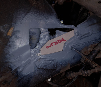

AX patched now.....
I forgot to take a pic, so I cleaned off all the new underseal I had just applied and shot a quick photo.... Back to Black.....
