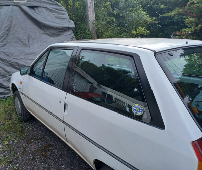

All done now.
I treated and painted the right side in the same way as the left.
Opened the seams with a thin screwdriver, used a thin scrapper blade to aid the capillary action to get the rust killer liquid in, filled those seams with ACF50, wiped off excess, painted with zinc primer, gray primer, Satin black to finish as a Mk1 type "flying roof......... filled the window seals with Bilt&Hamber S50 box section wax (thin) , used finger pressure to close up/tighten the seals, applied B&H S50 to the seams and then fitted the seals. Cleaned up the S50 that was pushed out with petrol on a rag.

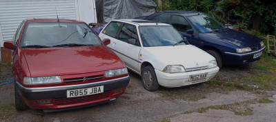

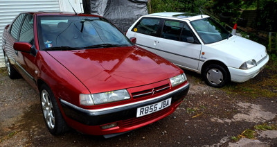

Re: I am an Activaist-v6 and a 2.1Estateerr
Tri Colore
Finally have a setAlasdair

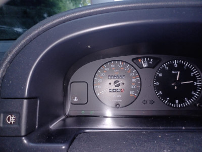

A Milestone reached for my AX.....and in 666 miles I think I will need an Exorcist
Caught it just before it changed to 66001
