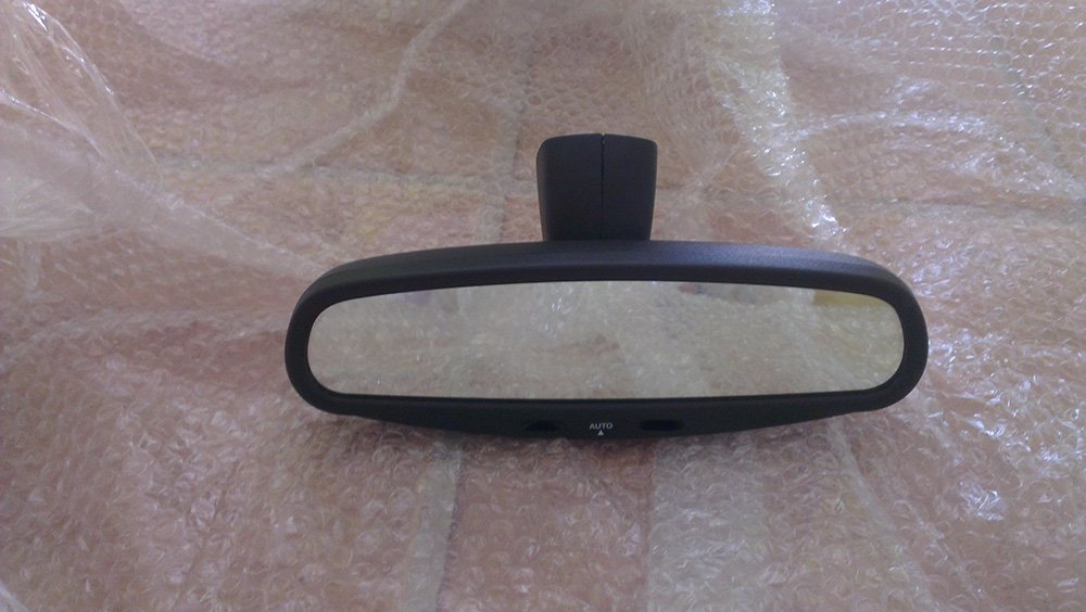

I've managed to obtain the interior electro-chromed mirror, used (as usual, at a great price), which is installed in X7s that have exterior electro-chromed mirrors as well. What distinguishes it from mine currently is that it has an AUTO button on the bottom, meaning you can turn on/off the dimming feature, and this is visible by the green LED in the corner of the mirror. Why bother with this? This is only Phase 1, Phase 2 will be when (and if) I manage to find exterior electro-chromed mirror glass, but if you consider one (1x) costs around 200 GBP new ... I'll try to pick a pair from a scrapped X7, if possible ... I just have to wait for the evening to be able to go out and test if it actually works as it should (the dimming part) ... if it will work, then I'll post up pictures of the procedure, if it won't, well ... no pictures ... ...

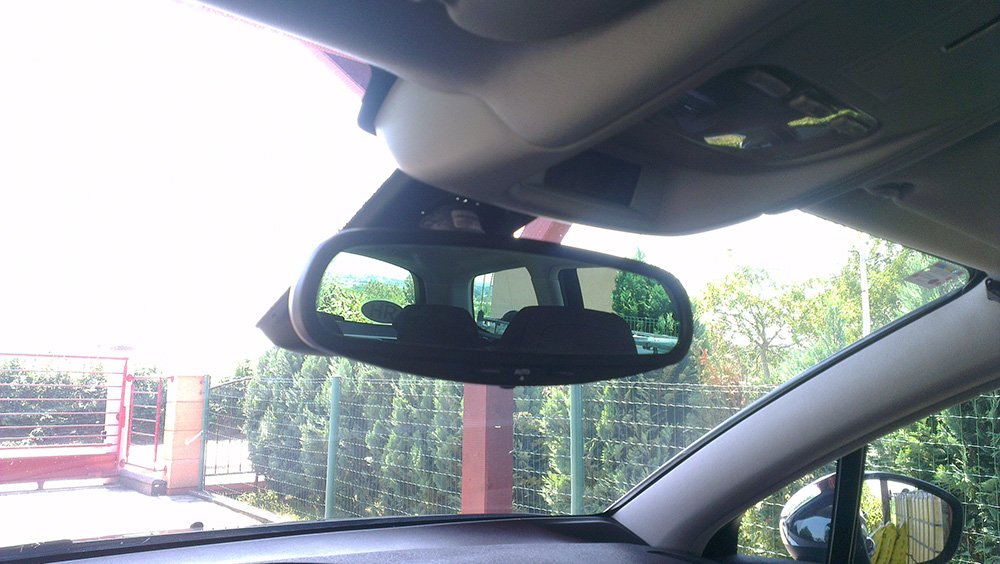

After a night test of the new (actually used) interior rear-view mirror, I've concluded that it works, and it also works with the Auto switch on/off, will I find it useful sometime, who knows. At least I was reminded during the test runs that when you put the car in reverse, the dimming is suspended, to allow for better rear-view visibility (yes, it says so in the user manual, but I'm not reading it daily). So, on to the procedure. My now old interior mirror was 0000815489, and the new one is 00008153TW ... if normal, you wouldn't find the latter alone, meaning it is always paired with external electro-chromed mirrors (I'm half way there, ain't I) ... Since I didn't make any check beforehand, I wasn't sure if the wiring would support any extra wires/connectors for the new mirror, which would make it a big issue later on.
"new" interior mirror

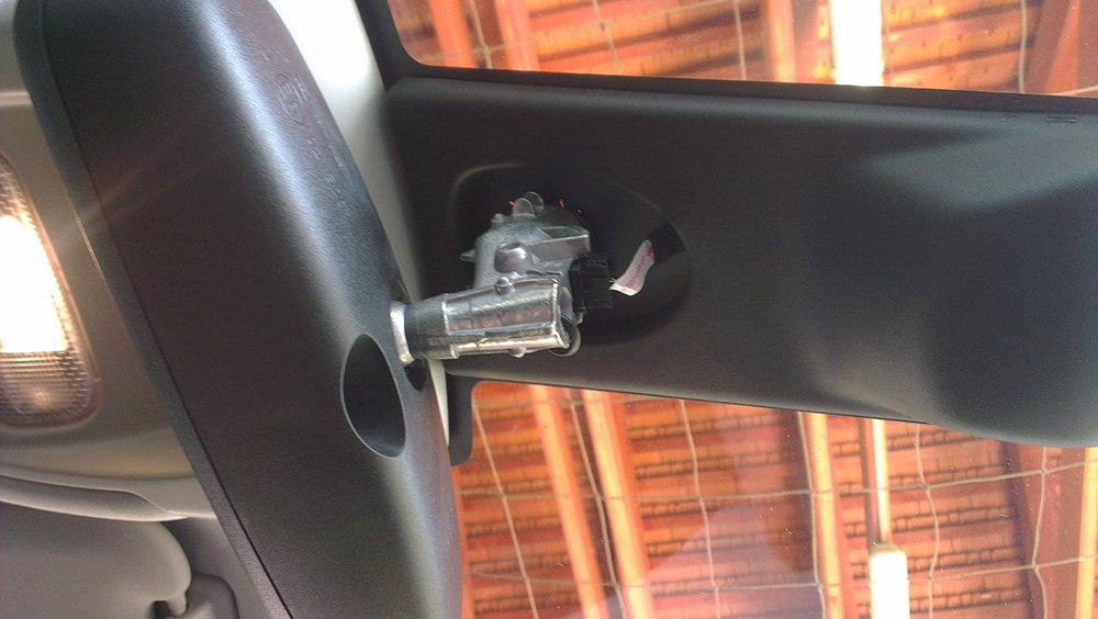

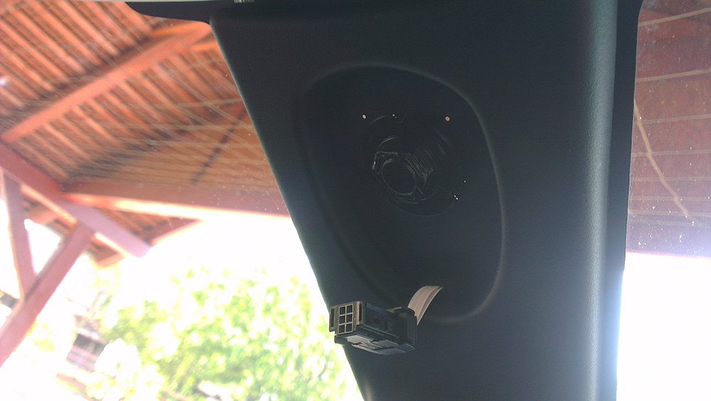

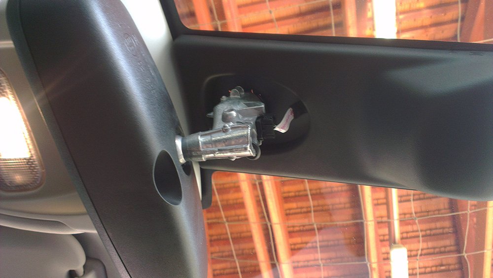

The 2 piece plastic cover that covers the hinge of the mirror is easily un-clipped, there are 3 hooks, you just have to get under one cover and slowly pry/unhook them. The connector has to be unhooked as well from the mirror (black square head), no tools required, just press in its side clip. The mirror can be unhooked the easiest way by doing a rotating action (in any direction) on the metal part regarding the central black bolt (seen on the following picture), a quarter turn should do the trick. It grips tightly, so you need to apply more pressure that expected while doing that.
after unhooking the mirror
Here it can be seen that there are 2 wire strips, which in total have 5 wires (2+3, if I saw correctly, the working angle could've been better if the central handrest wasn't in the way), thus my fear of not having all the connections was proven wrong.

almost-the-end result
The plastic 2-part cover is obviously missing in the picture, but everything was working at this point. After ignition, you get the green LED indicator constantly glowing (that is, if the Auto button is pushed inside - on position), meaning the mirror will be dimmed if required. And that's all there is to it.
Two short(and obvious) tips on how to quickly tell the two interior mirrors apart (applies to the electro-chromed versions only, the regular one has a very slim window joint, compared to these two that have much bigger plastic covers around the metal joint): outside view (sensor hole is in the middle bottom - only interior chromed | sensor hole on the side - interior + exterior chromed); inside view (sensor hole in the middle - only interior chromed | LED on the left, AUTO label center, sensor hole right - interior + exterior chromed).
