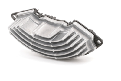

So just to confirm this is what you've replaced?

Yes although his was a different shape, it’s the squarer type with him not having automatic air con. He doesn’t have the digital screens controlling temp either side, just the twist dial
His was this shape -
Posts: 41992
x 6879
Re: Constant blower fan at full speed - Citroen C4 Picasso
Yes, that's the one. Just wanted to make sure - I used a poor picture previously.
So if this has been replaced with a decent branded replacement, I would be looking to the actual control unit on the Driver's side. These are still electronically controlled, but are no longer available new from Citroen.
