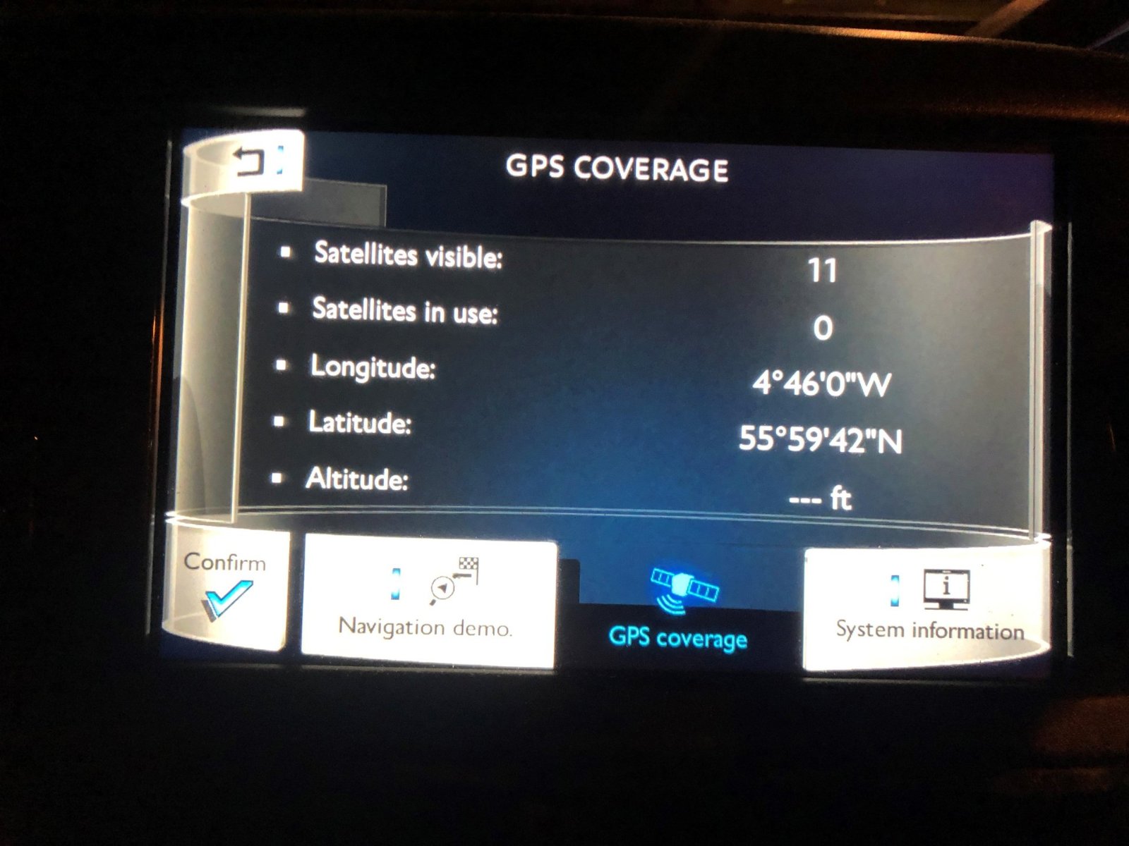

I have a 2012 Peugeot 208 1.6 eHdi and recently my sat nav just star saying I'm in a totally different location. When I check my GPS coverage it comes up as Satellites visible: 11 and Satellites in use: 0
Any ideas how I can fix this? Do I need to replace my GPS aerial? A but strange as it has the satellites visible but not in use.

I've done this and nothing change. More recently I noticed now it shows Satellites visible: 0 and Satellites in use: 0, so I suspect the GPS antenna is faulty.
Do you know where is located in my Peugeot 208 1.6 e-HDi 2012 and how I can change it? A tutorial wold be very helpfull.
