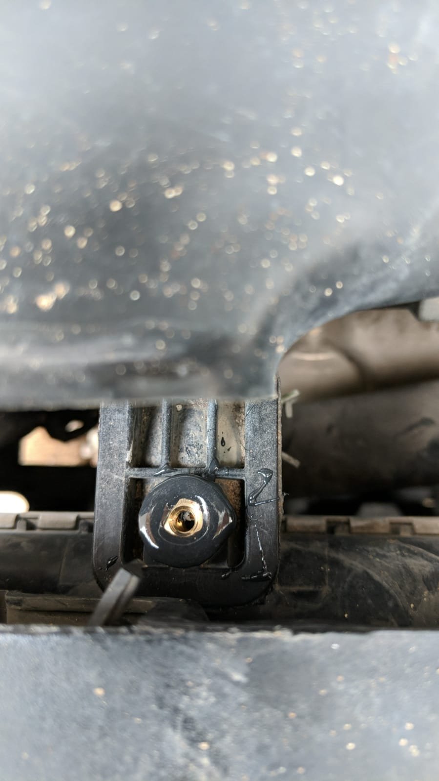

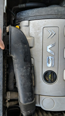

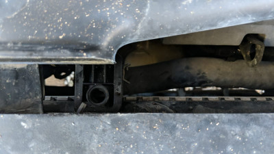

It looks like it was a M10 plastic bolt, with an oring and a large round head.white exec wrote: ↑04 Oct 2021, 20:23 If you could post a photo to show where it's missing from, that would help.
This is where the screw was... And this is where that hole is in a larger picture (finger is pointing)

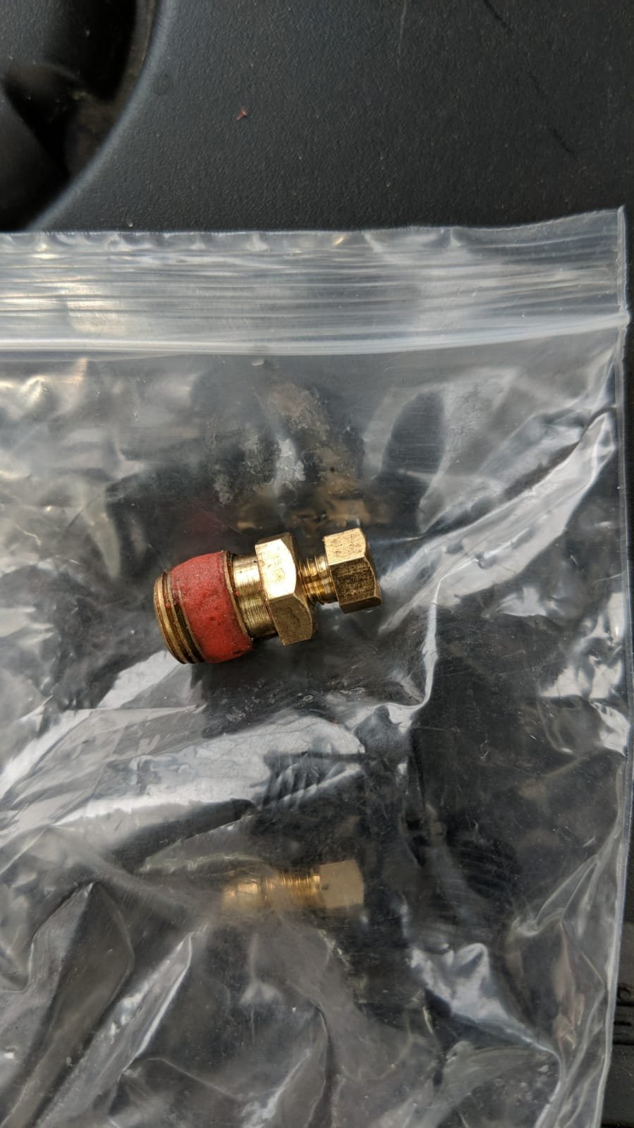

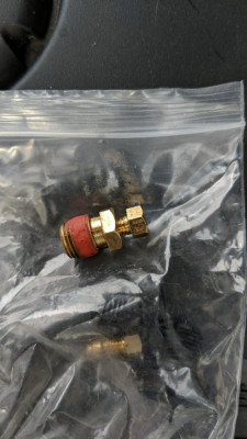

So.... the correct screw arrived and it was not the screw that was broken... it was the radiator itself.
So I bought a couple of these:
And JBWelded one to the radiator...
I hope it holds
I hope it holds

Hopefully it'll hold. The brass item looks very durable.
The thread of our BX here is M12, but it's in radiator plastic, so could get damaged.
The plastic screw-in plug is in a softer plastic (hard polythene, I guess), so it tends to be the plug that wears.
Only a bleed point, so it won't get a lot of use.

Re: Lost upper radiator bleed screw...
Fingers crossed, it survived today's drive to work... 15 minutes of highway/freeway and 20 minutes of stop and go trafficwhite exec wrote: ↑14 Oct 2021, 08:06 Hopefully it'll hold. The brass item looks very durable.
My other car is off the road since yesterday with a leaky oil cooler and the part is, of course, not going to be here for another week... The joys of living down here...
