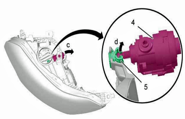

Re: C5X7 Can't code VIN in RD45
I thougt it was this module?
I tried to locate in on the car, since it shows as "No communication with unit"
C
C
- GiveMeABreak
- Posts: 37014
- Location: West Wales
C5 MK I 2.0 HDi SX Wicked Red
C15 Romahome White
XM 2.0 SX Polar White
CX 20 Polar White
GS 1220 Geranium Red
GS 1000 Cedreat Yellow - x 5648
No, that's only fitted on models with Xenon Directional Headlamps, which you don't have.

The dynamic beam corrector isn't shown as a part from your VIN, and from what I can see, the headlamp manual adjustment system consists of the 2 adjustment motors (one in each headlamp) and the manual adjustment switch on the dash.
Although I know there are some inconsistencies over these systems, so with hydraulic suspension, it may use the body height corrector data to adjust them if you don't have the manual adjustment switch on the dash - which may be for the metallic sprung versions without directional lighting.
As long as they work though... Just put the headlamps on against a wall at night and sit in the boot see if the beams move up or down according to the weight, (though you may need some friends or family members to assist

OK. I do not have the manual adjuster, so it has to be some form of glitch.
Thanks for info and patience.
