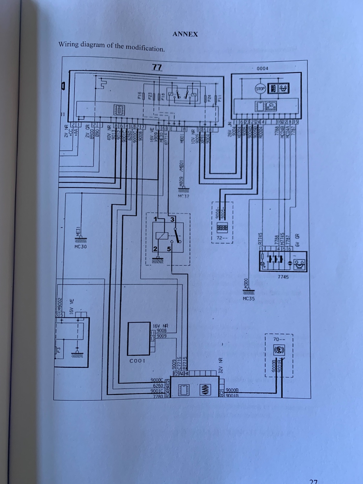

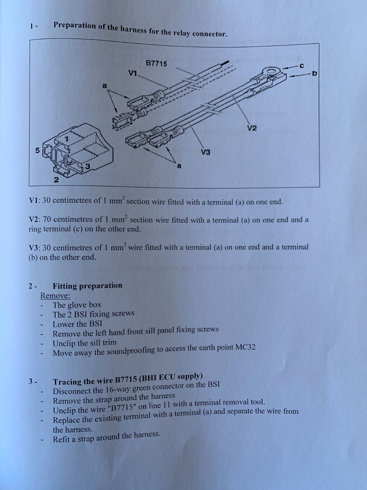

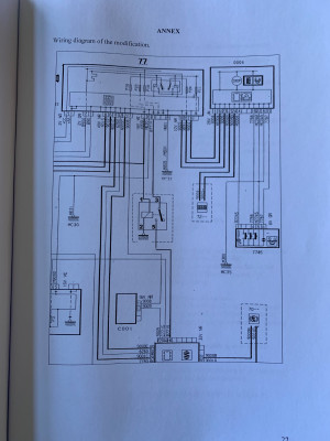

It was easier just to take pictures.
In the wiring diagram at the end the relay with the dotted line around it is the one you are adding.

Re: C5 BHI investigation query
The CAN lines can be seen at the bottom of the diagram, they are the 2 thicker pairs of wires shown on each side of the BHI in the diagram.
