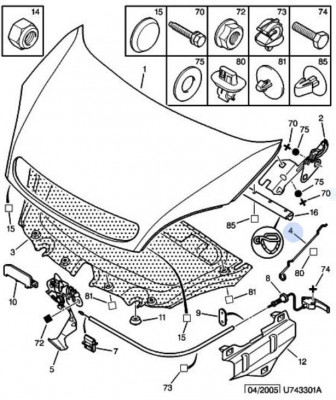

Re: 406 bonnet pull
I have nothing of help on this model, given the age. Info is limited.
This is all there is 20 is the lock (as I mentioned only one fitted left or right hand drive):

That diagram was for the original OP (406)

XSARA PICASSO FAMILY SALOON 2.0 HDi 90 Manual gearbox 5
This is what is shown as under there...
Click to enlarge As Marc said, a single catch.
Try leaning down heavily on the bonnet front while operating the release lever. It can lessen the upward loading on the catch.

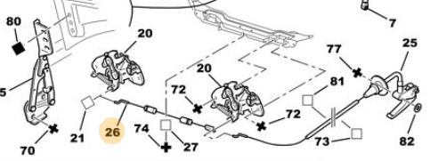

Re: 406 bonnet pull
It also looks its for a LHD 406, mine is RHD. All 406`s have two catches.
Anyway its sorted. The cable had unhooked itself from the O/side catch. The cable set up on RHD models with the bonnet pull lever on the o/side of the car, is odd. The lever cable goes to the N/side catch, then another cable goes from that catch to the o/side catch.
I took it to my mates garage, up on a two post lift. Remove undertray, long lever bar to the O/side catch, a few careful attempts to get in the right place, and bingo, the catch released.
