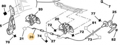

This is all there is 20 is the lock (as I mentioned only one fitted left or right hand drive):

That diagram was for the original OP (406)

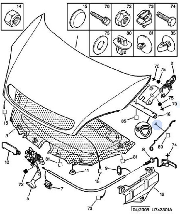

XSARA PICASSO FAMILY SALOON 2.0 HDi 90 Manual gearbox 5
This is what is shown as under there...
Click to enlarge
As Marc said, a single catch.
Try leaning down heavily on the bonnet front while operating the release lever. It can lessen the upward loading on the catch.

GiveMeABreak wrote: 06 Aug 2020, 22:28 That diagram was for the original OP (406)
It also looks its for a LHD 406, mine is RHD. All 406`s have two catches.
Anyway its sorted. The cable had unhooked itself from the O/side catch. The cable set up on RHD models with the bonnet pull lever on the o/side of the car, is odd. The lever cable goes to the N/side catch, then another cable goes from that catch to the o/side catch.
