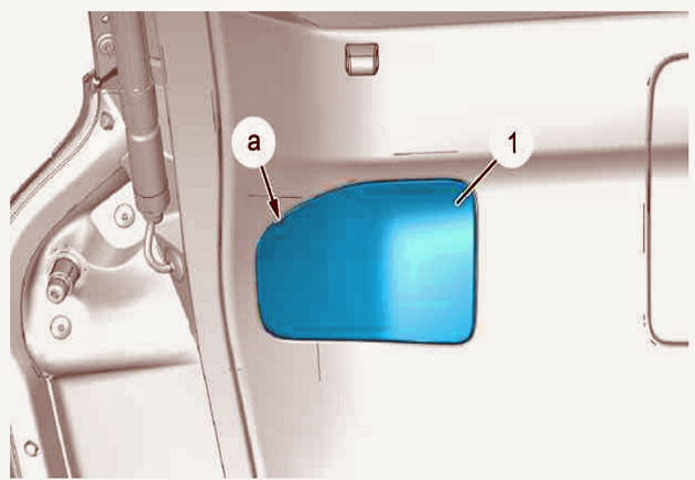

You'll need some trim removal tools to help. They recommend disconnecting the battery first (follow this guide BSI Reset / Battery Disconnect / Reconnect Procedure)
Removal
Unclip the cover (1) ( at "a") using trim tools.
Remove the cover (1).
Remove the bolts (2).
Disconnect the connector (at "b").
Unclip the tail lamp (3) (at "c").
Detach the rear lamp unit (3).
Remove the rear lamp (3) (In the direction of the arrow ).
