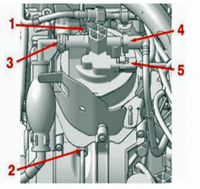

Open:
  • The breather bolt (1)
  • The drain screw (2)
Disconnect:
  • The fuel connectors (3 - 4)
  • The connector for the heating element (5)
Pour the degreasing agent into a container (According to equipment)
ESSENTIAL: Cover the fuel connectors with covers supplied in the filter kit .
Unscrew:
  • The cover (6)
  • The (7) bolt
Remove the screws (8).
Slacken the bolt (9).
Remove:
  • The fuel filter (10) protector
    The filter bowl
Drain the remaining fuel contained in the bowl into the draining tray .
Clean the fuel filter bowl using a brush and degreasing agent SODIMAC 35.
Before refitting, allow the fuel filter bowl to drip.
CAUTION: Do not use compressed air.
Tighten the drain screw of the float chamber.
CAUTION: Mounting of the diesel filter assembly on a vice is strictly prohibited.
