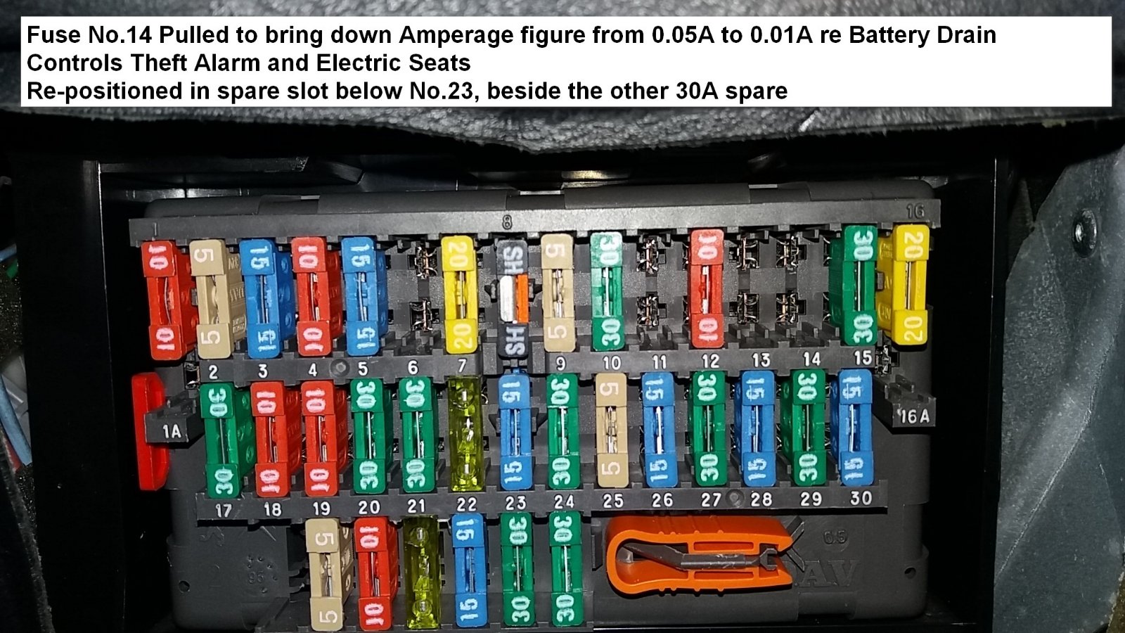

Another small update
Sound is restored to the Radio, I've put Fuse 14 back in. Removing it cured my Parasitic Battery Drain back in October 2018. It was a no-brainer at the time coz it deals with the Theft Alarm' and Electric Seats.... well the first I don't use coz the car's never had a 'Plip' key that works and the second my car hasn't got electric seats anyway, so I thought I'd not miss the Fuse.
....or maybe I was wrong, coz since removing it back in Oct 2018
sound with regard to the Radio, as described; had gradually got worse
as had the locking system's 'party piece'
...this involved the Central Locking activating the moment you pull the NSF Door Release (which I'm sure has no electrical connection), thereby preventing access / egress.
So, Fuse 14 is back in place, but that means my Parasitic Drain is back too, so I can listen to the Radio, but I have to disconnect the Battery when the car's stood.
My Thread "Compression: Turnover" related to this, but its a bit all over the place [that's not like me, lol] and I don't appear to have noted the eventual resolution there, so I wouldn't bother finding it if I were you. For that reason I've not included a link. I'm sure I did say what'd happened somewhere here but not on the relevant Thread!
The below pics were taken back in Oct 2018
Anyone got any idea:-
1: why disconnecting this Fuse affected my Speakers? (only the Speakers, the Radio Unit itself worked as normal, just without sound)
2: why the issues resulting from removal of this fuse took over a year to 'kick in' properly, probably not 10,000miles this past year, but certainly 5k+
3: how to fix my parasitic Drain. I know its on the Fuse 14 Circuit....
...maybe next thing to do will be to pull the plug on the little box o' tricks inside the Drivers Door; there's a PCB inside, its purpose is something to do with the Central Locking I think; but that's all I know
and while you're at it...
What's a 'Shunt' Fuse? (Fuse 8), what's that mean? Don't talk to me about Shunts, lol! Can't find Daughter a car, nothing out there fitting the description, with a documented Cam Belt change. Favour a 206SW or Ford Fusion, preferably with the 1.4HDi; anyone got one?
Puxa

WRT #2, that's a very strange symptom there. And where strange electrical symptoms are, I've generally found bad earths are there as well. If it was mine I'd be checking all the earth connections in the engine bay, under the front carpets and also the +ve connections to/from the back of the fuse box.
Almost definitely something amiss with the wiring on a car this simple and non-multiplexed. Maybe it's just jealous of the weird faults BSI's and COM2k's can cause so thought it'd have a go at copying them!
#3, I'd study the wiring diagram for that circuit and begin disconnecting parts of it one at a time until the amperage drops. If everything ends up unhooked and the draw is still there, it's more likely either in the fusebox itself or damaged loom somewhere which is a pain but at least physical damage would be easier to see. To be honest, I'd probably start to address the whole thing by having a good look at the arse end of the fusebox itself to check for corrosion/damage there as it seems to be affecting multiple unrelated circuits.

The 'shunt fuse' is included in many PSA fuseboxes as a means of dealers/factory being able to easily disconnect from the system all those items which would be a constant residual drain on the battery - eg radio, alarm... - when the car was "laid up" in storage/delivery, prior to sale and regular use. Such storage can run into months (years in some cases!), and so avoids batteries going rapidly flat.
Even with the shunt removed (or in its 'storage' position), the car should be able to start and drive. For regular 'customer' use, the shunt fuse is usually transferred into a second position, where the residual bits are enabled.
See Owner's Handbook for details.

ekjdm14 wrote: 10 Jan 2020, 09:56 …where strange electrical symptoms are, I've generally found bad earths are there as well.
Thanks for that ekjdm, I so ‘know’ that you’ve hit the nail on the head there. I’ve not had a chance to have a look at it yet, but it simply stands to reason that you’re right…
