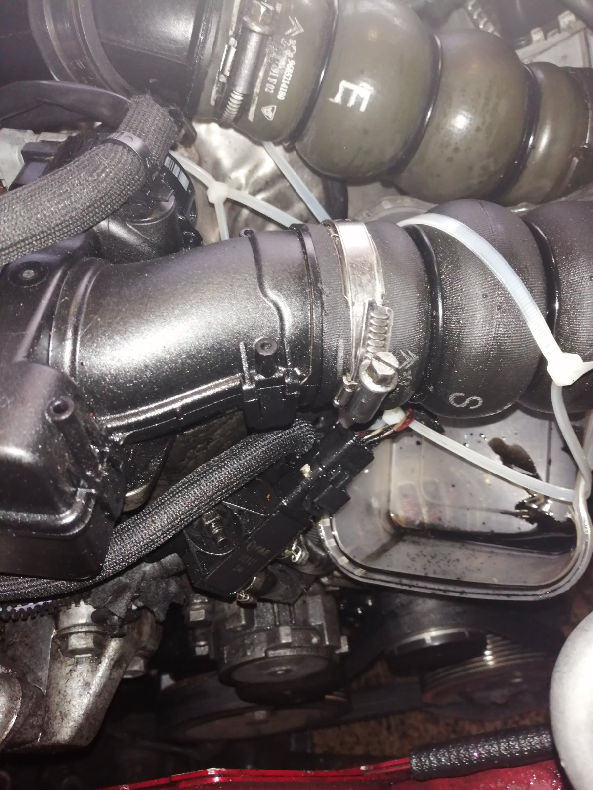

I have used cable ties to support a Chinese Takeaway box to catch the oil that drips, but in the main around the rocker cover is now very dry.
I shall upload a photo shortly..... Ironically the box is less oily now as when it arrived with Chowmaen in it.
