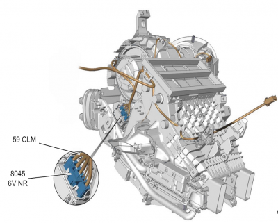

It's not that simple Mike - I already checked and all it states if (where separate for both the control module and the blower motor), so clear as mud.
This is the location - but to repeat, parts filtered to VIN show as not fitted.

This is what I mean:
8045: Blower Control Motor (if separate)
8050: Blower Motor (if separate)
Unfortunately the 3 digit wiring codes are 'unknown', so I can't tell you what they relate to. This is the C4 / DS4 with Single A/C and manual control with mechanically cable operated vents / mixing.
The full digital system is a lot more involved but shows similar wiring on the Blower Motor Control Module, with the exception of wired on Pins 5 & 4 being differently coded.
So why, if these both use the same Blower Control Motor is it not shown as a part on the parts system I don't know.
