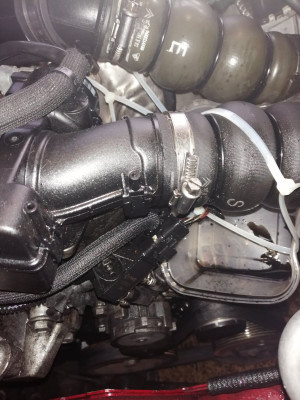

£80 was leak off seals (which Citroen doesn't supply without the leak off pipe which I didn't use) and also a new a Rocker Cover and gasket as the air/oil seperator diaphragm isn't supplied on its own I replaced the whole rocker cover. £80 was parts.
I have used cable ties to support a Chinese Takeaway box to catch the oil that drips, but in the main around the rocker cover is now very dry.
I shall upload a photo shortly..... Ironically the box is less oily now as when it arrived with Chowmaen in it.

I'm rather fond of cable ties! You can register for free on service box register as an independent trader. Using your VIN you can look up most parts and get a part number. Then you can shop around for the best deals. I discovered Ford use the same part numbers as Peugeot I got injector washers and collars for €4, local Peugeot dealer wanted €3 each for the copper washers.

Did you attend a night class in cable tie lacing :-D
