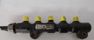

This is the fuel rail pressure sensor. Weird that the diagnostic dosent show this problem. Can someone help me with the oem part number for this part?

Re: Citroen C5 2009 EGR valve
The EGR won't be near the rail - the rail fuel pressure sensor is on the end of the rail here on the right hand side - item (1)
Your photo is hard to identify what you are looking at as it's too close in.
Citroen only sell the complete rail with sensor.

Here can you see that the sensor is right under the egr valve
The part for the fuel rail (with sensor) is 1570G2:
You can get the sensors on their own from aftermarket suppliers.
