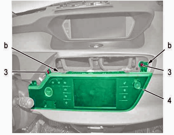

Maybe you have radio removal manual? Iknow it sits behind 7' lcd screen. It would be great to know how to remove it without breaking hidden screws.

Re: C4GP radio wiring
It's done in several stages - you'll need to remove the central vent then the display...
First, you must disconnect the battery - if you do not you can brick your Audio / display when disconnecting / reconnecting power!
Use this procedure and again when reconnecting later on:
BSI Reset / Battery Disconnect / Reconnect Procedure
Removing Central Vent
Dismantling the Touch Screen
Removing Radio Unit
Refit in reverse order and ensure you follow the section to reconnect the battery in the link above.
Unclip the central air vent (1) (at "a") using trim removal tools. Detach the central air vent (1). | Disconnect the connector (at "b"). Remove the central air vent (1). |
Unclip the trim (1) (at "a") using trim removal tools. Remove the trim (1). | Remove the bolts (2). |
N.B.:Unlock the steering column, pull fully and lower it. Remove the bolts (3). Unclip the touch control panel (4) (at "b") using trim tools. Detach the touch control panel (4). | Disconnect the connectors (at "c"). Remove the touch control panel (4). |
Remove:
Remove the START/STOP button (5). |
Remove the bolts (2). Remove the radio (1) from its location. | Disconnect the connectors ( as "a") (According to equipment). Remove the audio system 1. |
