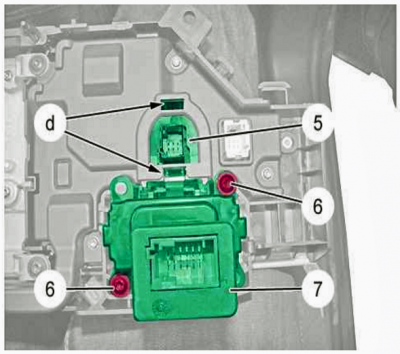

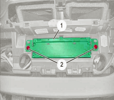

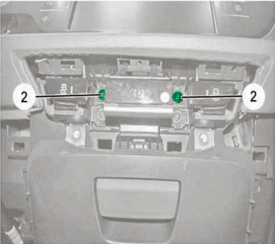

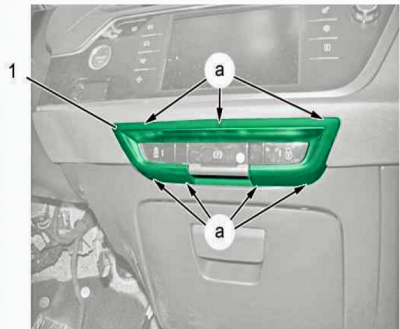

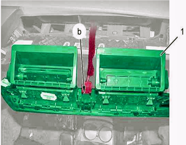

Unclip the central air vent (1) (at "a") using trim removal tools. Detach the central air vent (1). | Disconnect the connector (at "b"). Remove the central air vent (1). |
Unclip the trim (1) (at "a") using trim removal tools. Remove the trim (1). | Remove the bolts (2). |
N.B.:Unlock the steering column, pull fully and lower it. Remove the bolts (3). Unclip the touch control panel (4) (at "b") using trim tools. Detach the touch control panel (4). | Disconnect the connectors (at "c"). Remove the touch control panel (4). |
Remove:
Remove the START/STOP button (5). |
Remove the bolts (2). Remove the radio (1) from its location. | Disconnect the connectors ( as "a") (According to equipment). Remove the audio system 1. |
