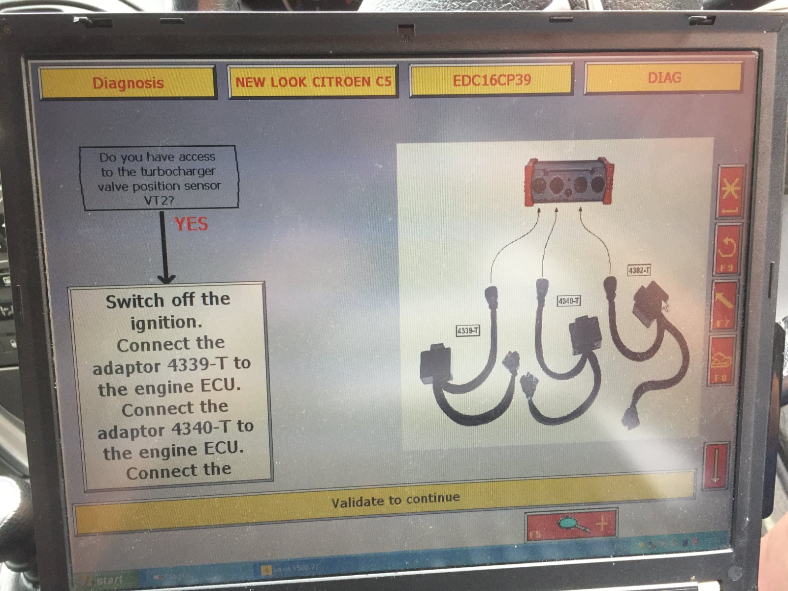

The Engine Management light was on and anti pollution fault Lexia showed various EGR faults including short circuit and high voltage.
I am an Electrician who specialises in controls (Former Motorcycle Technician Early Eighties) and I thought it would be the EGR valve fault. Motor shorting rather than wiring?
I took my time as the Haynes Manual does not cover this engine model and replaced the EGR valve. Still the same fault.
So it looks like the wiring could have a fault.
I will add some Lexia screenshots.

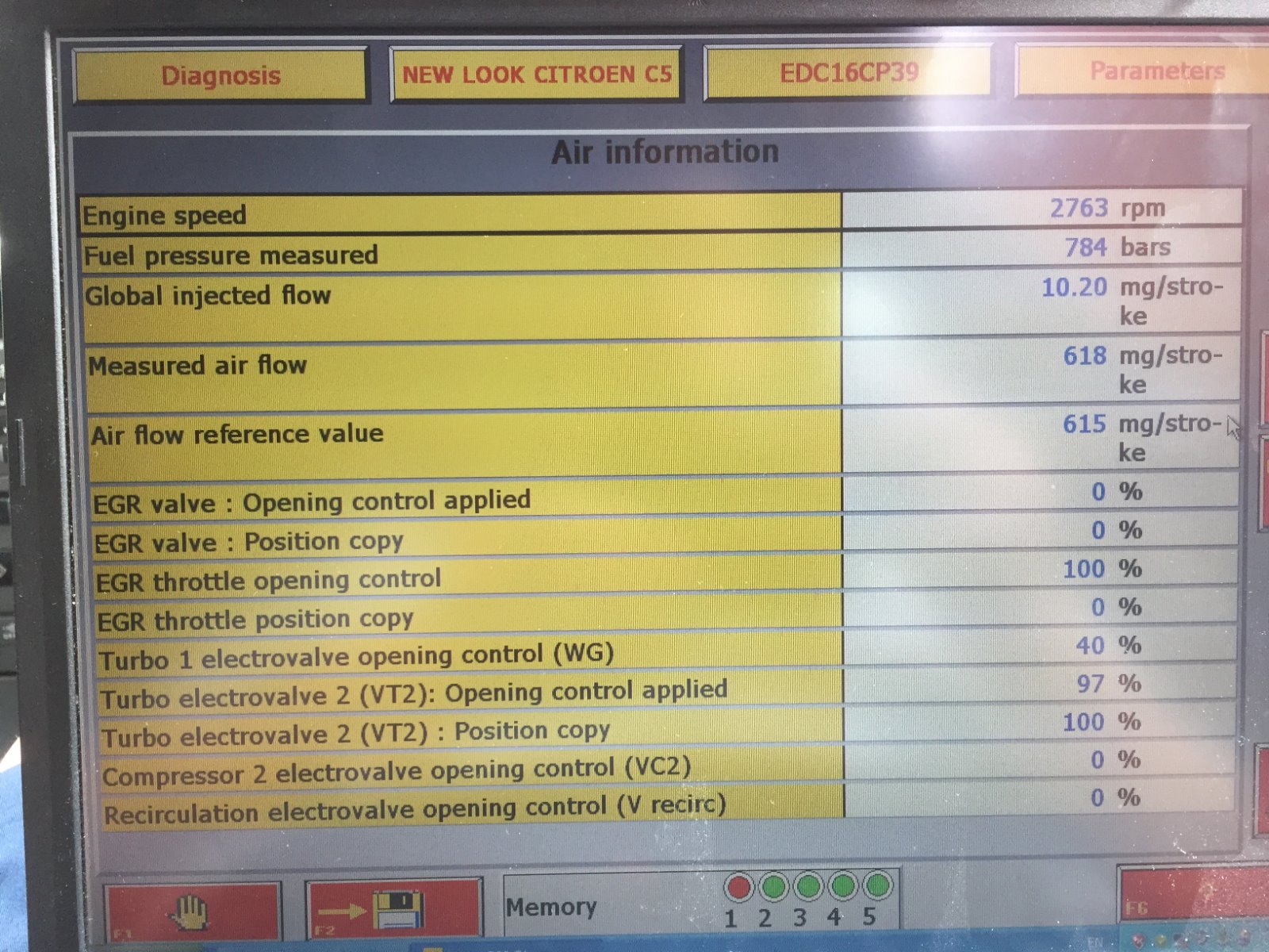

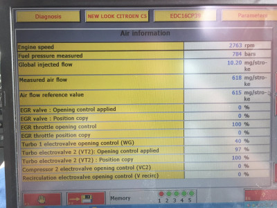

This is the air live data
It also comes up with speed control fault.

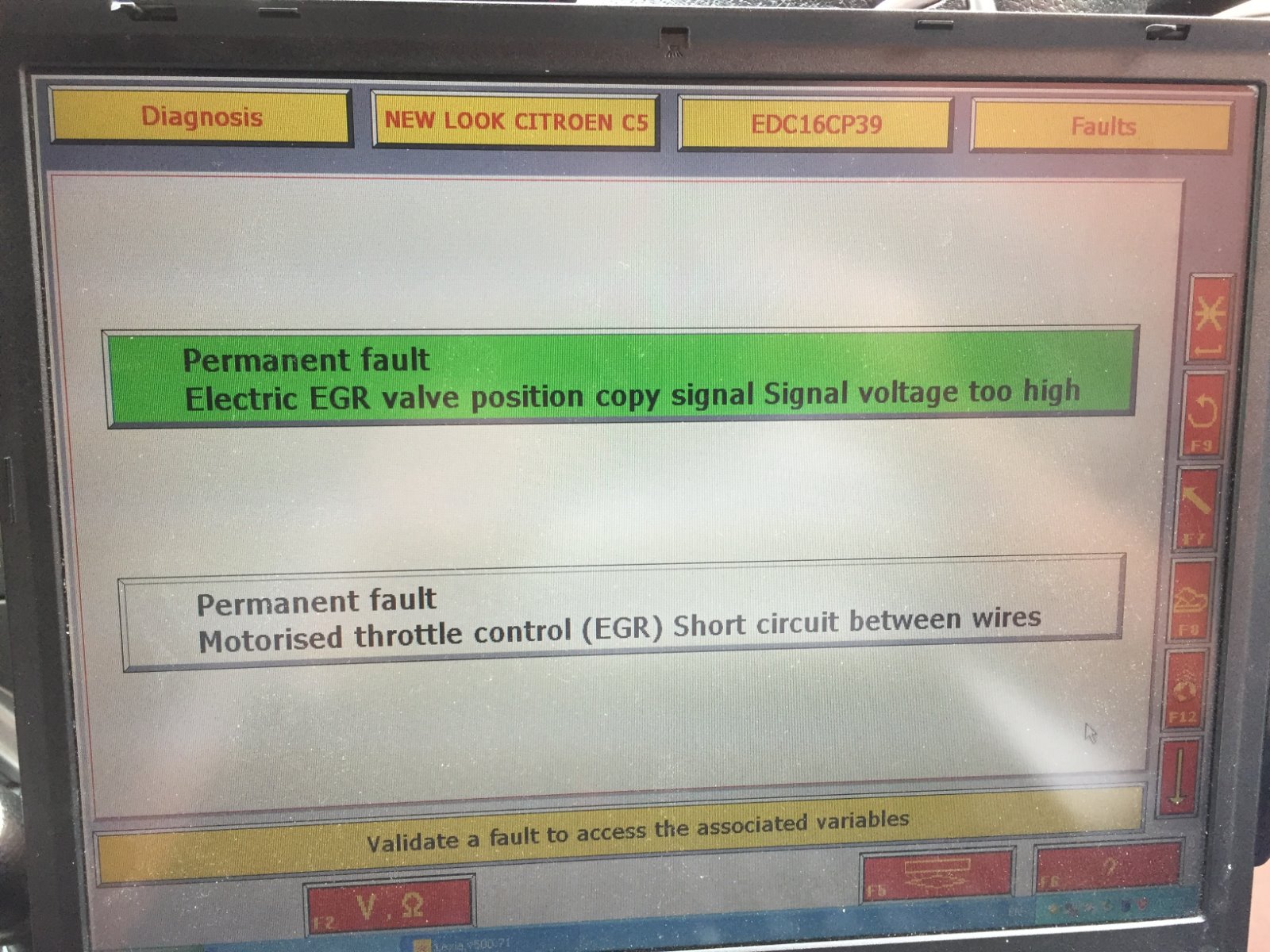

One of the faults listed is EGR throttle fault. Not to be confused with EGR valve. I assume this is at the throttle port?
I found a section on Lexia that activates replacement EGR valves but this just raised false hopes.

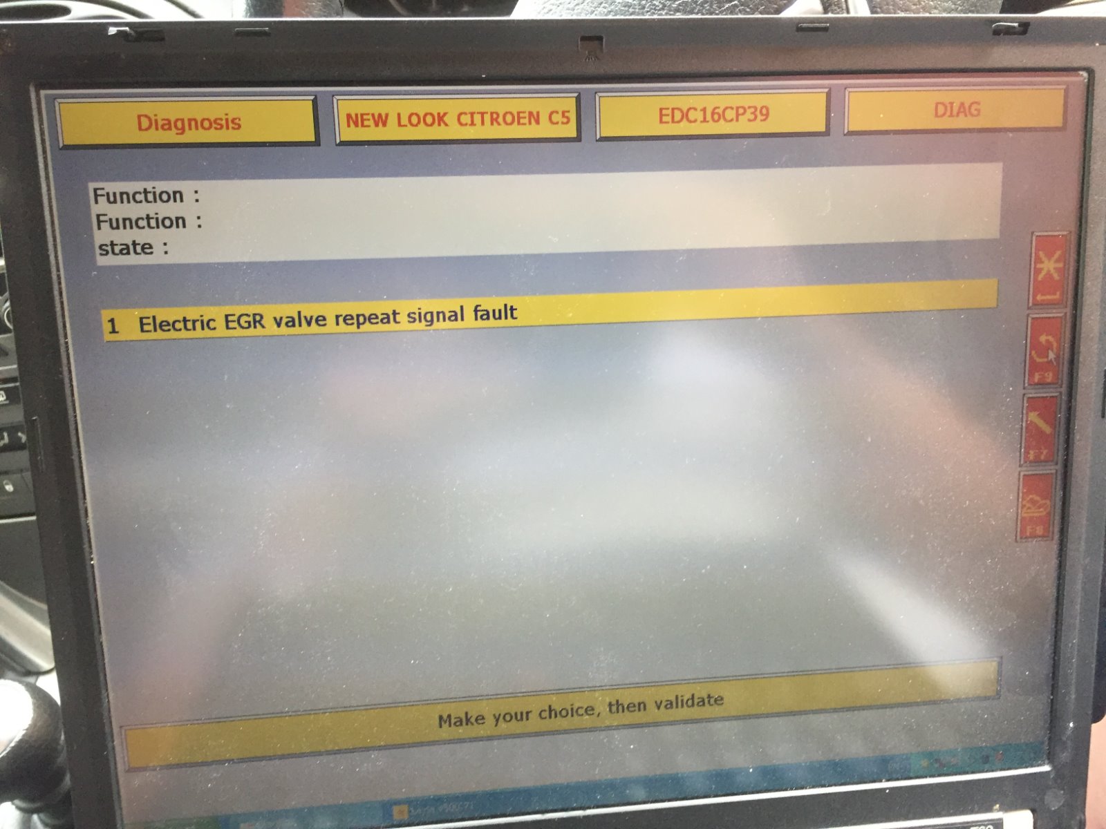

Here is the persistent Lexia fault screenshot
Here is the Electric EGR valve repeat signal fault.

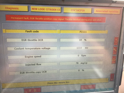

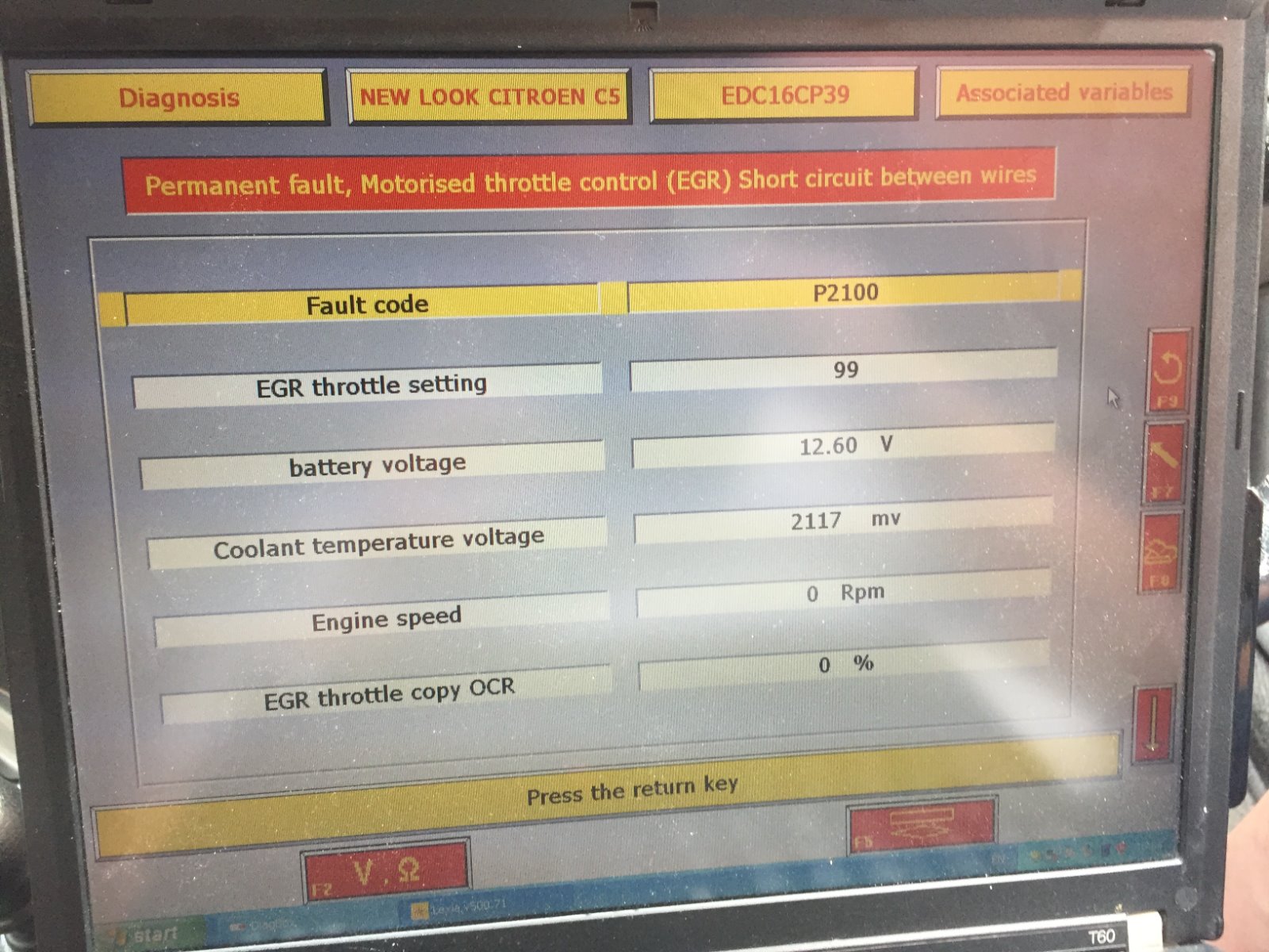

Fault details permanent fault P2100
Fault details P2111 permanent fault
Fault details P0406 Permanent Fault
Does anyone know where the Injection ECU is? There appears to be an ECU next to the BSI unit but it does not look like this.
The one I have found next to the BSI has the same EDC16CP39 part no as on the screenshots.
