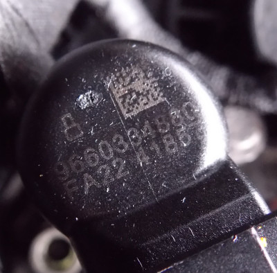

So I got a new injector and fitted it but now need to code it, the WoW scanner can do it but the codes on the top of the injectors are not very clear.
any advice?

Ok, so is it the same class as the one you removed? These should be either class 4, 5 or 6 and cannot be mixed, unless replacing all of the injectors with the same class.
- GiveMeABreak
- Posts: 37433
- Location: West Wales
C5 MK I 2.0 HDi SX Wicked Red
C15 Romahome White
XM 2.0 SX Polar White
CX 20 Polar White
GS 1220 Geranium Red
Re: Getting fed up!
Some like yours, should just have the classification and this is all you need to code it: Classification 4, 5 or 6 as per the table below for the Siemens ECU. Other ECUs can be different and some require par of a code to be input, but no yours.
So the marking shown as 'e' should correspond to the table above - and you should just need to enter the single classification. But as said, it must correspond to the same classification as the existing ones. Mixing classification types will stuff the particle filter system.

My advice would be to take as good a photo of the numbers as you can, then blow the image up on a screen to try and work out what they are.

No joy with any of that, the new (recon) injector throws up all sorts of faults and puts the car into limp mode so for now I've put the original one back in.
It runs sweetly but still weeps slightly at the thread, I've fitted a new washer and tightened it as tight as I dare.
No fault codes showing on my scanner or on the dash.
Got a couple of photos, two of the originals and the recon one supplied, I checked and double checked with the supplier before buying and was assured it's correct and with a 12 month warranty
The originals with the FA prefix, the recon with G

Re: Getting fed up!
Well from what I can see what he's sent you aint right!
Citroen part number indicates 1980J9, a class 7 injector and that matches up with the
9660334880 injector as shown on your originals from your picture.
Example of a VDO here:
https://www.buycarparts.co.uk/vdo/7515477
What he's sent you is a 9663429286 which for all accounts is for a 1.4 HDi engine!
There are several injector parts for your VIN:
The one above that I mentioned, plus:
1980Z5 - Class 7 one here:
https://www.pfjones.co.uk/citroen-c5-ii ... 13552.html
I won't list the others as they are different classes. But both these fit both the 96 and the OEM number and should not need to be coded if you keep the class as the same.

Thanks Marc, I've just done a return request on Ebay.

All sorted now, running fine and no leaks.
