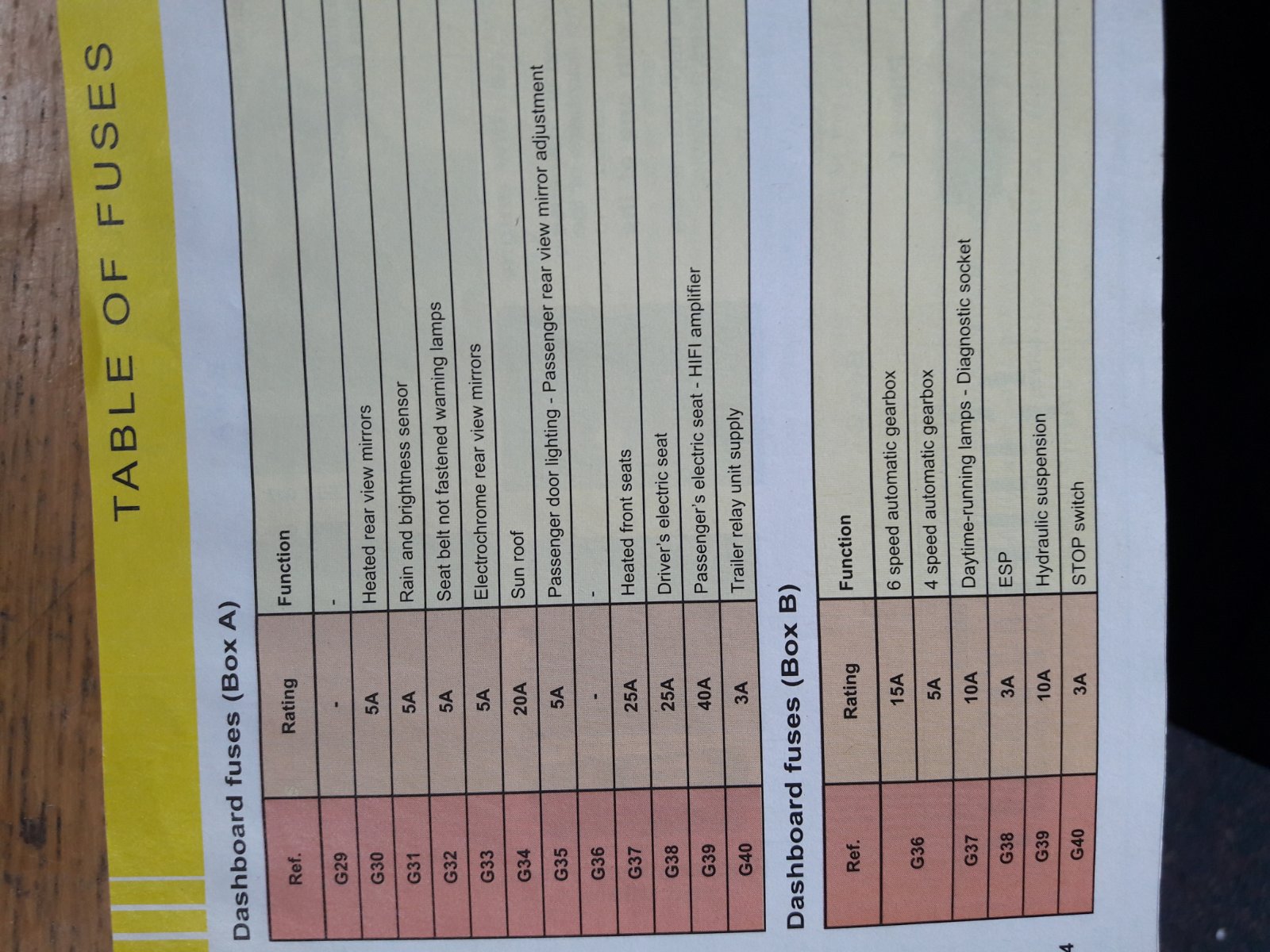

They were ok yesterday - my sister in law complained about the heat in her seat which had been left switched on. But now neither seat will heat up - nothing on any setting. Fuse G37 is fine, so I don't know what to look at next, any suggestions? Will Lexia give a clue - can't remember if it does stuff like seats?

Be aware that there are 2 G37 fuses! - But in either case it's not this one you need to be checking.
In fact they are fuses:
G38 (25A) - Driver's Heated Seat and
G39 (40A) - Passenger´s heated seat - HIFI amplifier - Cielo (where fitted)
Both these are in the BH12 cabin fuse box that contains 12 fuses in a row and range from G29 to G40.
Don't get this confused with the BHF1 cabin fuse box that contains 5 fuses (G36 to G40)
These can be hard to see as they are to the side and above the BSI.

We've been here before Marc - conflicting info from different sources. My C5 handbook - edition 10/2007 says fuse G37. My Revue Technique Manual agrees with you - fuses 38 and 39. As both seats failed together I am inclined to agree with the handbook ie only one fuse. Additionally I removed G38 and, as per handbook, drivers seat stopped moving.
Anyway must be something else......?
