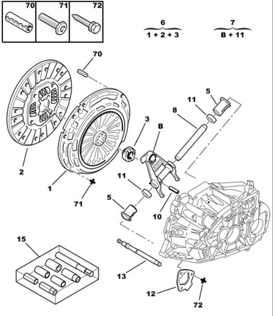

For the 2.1D there is a specific note about the clutch fork and the push rod of the clutch control receiver must be matched up.

The Xantia 2.1 TD has the same clutch and gearbox as the Xantia 2.0 HDI (110) and the Xantia TCT engines. It is a hydraulically operated clutch, and some care is needed not to damage the hydraulic components which are now difficult to source.
See viewtopic.php?t=54694 for a long and meandering description of the replacement of one of these clutches on an Activa.

Some earlier build MKI 2.1 didn’t have the hydraulic clutch and there was specific info for that reason that I mentioned. I will dig it out but better to have the VIN first so we can determine whether this applies based on the build date.
Edit: See info in my next post - with ref. to modification

I'll amend that bit about the Hydraulic clutch Mike - I should of said it's about the clutch fork mods.
From build dates 6748 (01/05/1995) to 7113 (30/04/1996)
Clutch: All types except for: Turbo CT , 2.1 Turbo D
"push" type clutch : 1.6i, 1.8i, 1.8i 16V, 1.9D vehicles.
"pull" type clutch : 2.0i, 2.0i 16V vehicles, 1.9D Turbo D.
Clutch: Turbo CT, 2.1 Turbo D
"Pull" type clutch.
Hydraulic clutch control: Type XM.
Pre-filling of hydraulic fluid, this type of control, tight and without maintenance, enables the automatic adjustment of the clutch pedal movement.
The clutch pedal movement isn’t adjustable.
The clutch control consists of:
Hydraulics reservoir - Bulkhead (engine side). The tank supplies the fluid needed for the control’s functioning
A transmitter cylinder controlled by the clutch pedal
A receiver cylinder, fastened on the clutch housing, enabling the change of position of the fork
A transmitter-receiver connection ensured by hydraulic channeling
In the case of failure, the clutch control has to be changed completely.
This is the mod:
Applicable to ML5T and BVM5 boxes since build date: 6951 (20/11/1995)
Vehicle application:
XANTIA Turbo CT
XANTIA 2.1 Turbo D
The mounting for the slave cylinder is built into the gearbox.
(1) Gearbox.
(2) Slave cylinder.
(3) Support.
(4) Piston rod.
(a) Location of the gearbox identification number.
Part removed: Slave cylinder mounting (3).
Modified parts:
Gearbox: The slave cylinder (2) fixing boss is thicker by 19 mm
Clutch control: The slave cylinder(4) push rod (2) is 12 mm longer (107 mm, instead of 95 mm)
Clutch Control
The length of the push rod distinguishes the new slave cylinders from the old ones: (107 mm, instead of 95 mm).
Clutch Control
The old slave cylinder is no longer available from the Replacement Parts Division.
The new slave cylinder, together with 2 push rods, is available from the Replacement Parts Division.
Replacing an old slave cylinder with a new one:
Only the new parts will be available from the Replacement Parts Division once stocks have been exhausted.
The long push rod ( 107 mm) is available from the Replacement Parts Division.
Replacing an old gearbox with a new gearbox:
Possible Causes of Clutch Judder
"Pull" type clutch.
This is the mod:
XANTIA Turbo CT
XANTIA 2.1 Turbo D
(1) Gearbox.
(2) Slave cylinder.
(3) Support.
(4) Piston rod.
Modified parts:
Gearbox reference | ||
Vehicle | New | Old |
XANTIA Turbo CT | 20 LE 15 | 20 LE 06 |
XANTIA 2.1 Turbo D | 20 LE 14 | 20 LE 00 |
Clutch Control
- Fit the slave cylinder with the long push rod to the vehicle
- Press the clutch pedal to break the pins holding the push rod
- Remove the slave cylinder
- Replace the long push rod with the short push rod
- Refit the slave cylinder
- Remove the slave cylinder mounting
- Fit the slave cylinder with a long push rod ( 107 mm)
Incorrect grease on splines:
| Tangential strap bent:
Diaphragm spring fingers bent:
| Facing contaminated with grease:
Wear marks on release bearing inner bore:
| Facing worn on flywheel side:
Damaged hub splines:
| Release bearing worn:
Release bearing incorrectly lubricated:
| Worn gearbox snout:
Push rod wear mark off centre:
| Flywheel scored:
Tangential strap damaged:
| Damaged bearing lugs:
Facing contaminated on the inner portion:

Re: clutch 2.1 dual mass flywheel
The clutch plate is a LUK 235 Diameter, was part number 2055AV, it has been replaced with 2052 V3
The clutch mechanism itself is 2004T5 230 Diameter, replaced with 2052V9
...and no DMF, just a solid flywheel, 0532G2

Thank you very much. will pass that on.
