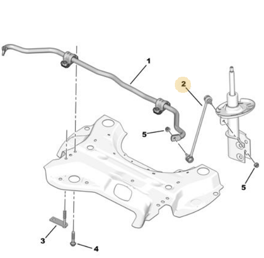

You have drop links and these have bushes - but you need to replace the drop links - it's not feasible to replace the bushes on these realistically. They're not really designed so be used forever.
Item 2:
Drop links: 9831547080 £34.70 each inc. VATn
Nut and Base (always replace): 9817224280 1.72 inc. VAT

In the picture you've added - number one is the anti-roll bar.
It has 2 securing bolts (shown either side on the number 1).
Inside these are usually circular rubber bushes. It's those that I'm referring too.
I'll be changing the drop links with the rest of the shocks/springs, but I also wanted to change the anti-roll bar bushes too.

They don't supply those separately at the dealer as you can see from the diagram, so you'll probably have to source them elsewhere like you seem to have found. It's not a common problem I've heard of - but there's always a first time.
