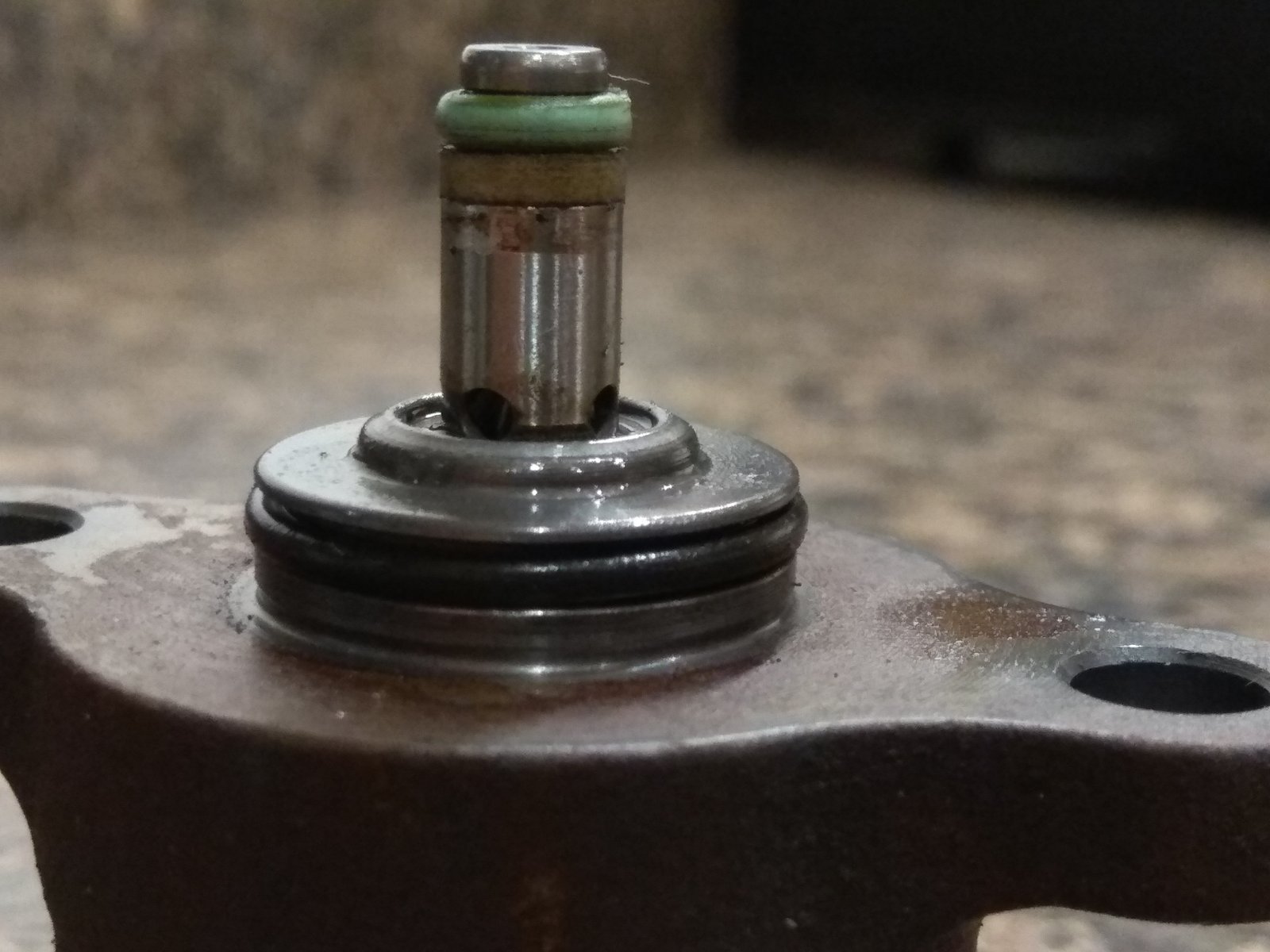

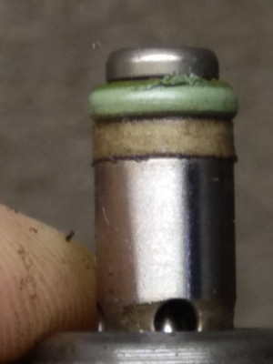

HP Regulator has now been replaced and the car is driving much better. At idle the needle is steady and when taking off there is no lurching or delay. However, looking at the old regulator this does not seem to have failed in the same way as described in this thread.
It looks like there was an impingement on one side of the shaft as noticeable abrasion can be seen from the attached photos. Is this something to continue to worry about with the new regulator? The old one was original and was tightly screwed in.
My understanding was this the HP regulator issue was with a small gauze filter. That is not the case here.
My concern is the the abrasion will now happen to the new regulator.

Re: 2.0HDI hunting at idle
Apologies for bumping this - it dropped off the first page without a reply.
I was just wondering if the abrasions are expected for a 17yo part or whether they are an indication of something else having gone wrong.
Thanks.
Thanks.

Not all the regulators were fitted with the filter, in fact I got I best results from one that wasn't. You can buy used ones very cheaply from ebay and that's what I eventually used.
I managed to get a new Bosch one for £80 but I'm concerned that the wear marks shown in the photos on the old one are due to something internal to the pump which will eventually screw up the new regulator I've fitted.
I think my original had done something like 200,000 miles so I wouldn't worry to much.
