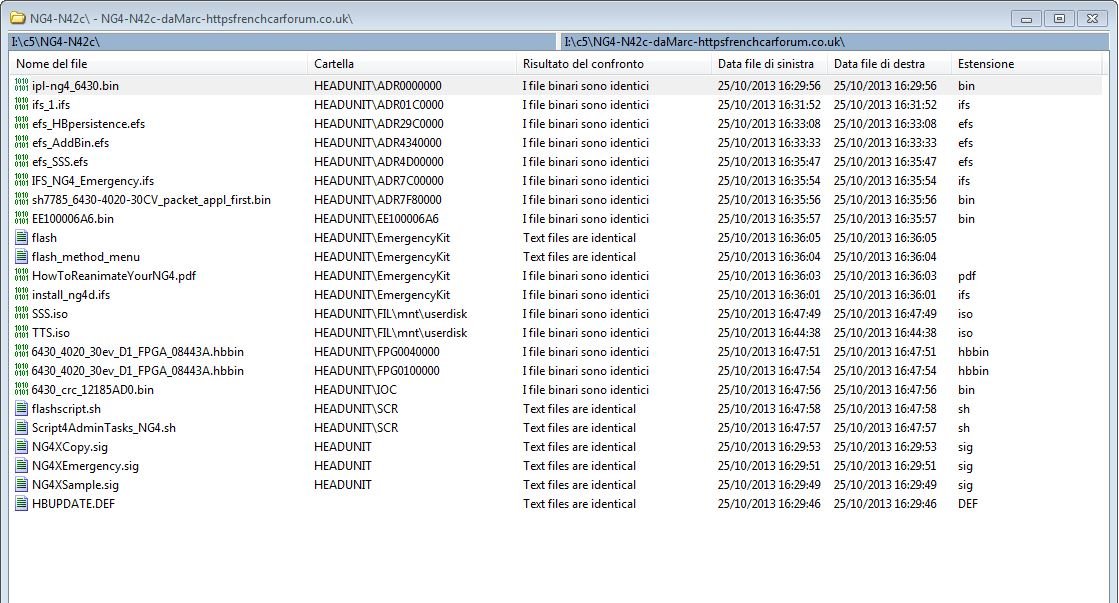

Re: Guide to Replacing the NG4 Navidrive 3D Hard Drive with a CF Card
Post by geoc5 »
Marc,
sometimes very strange things happen, and for me inexplicable.
After the last failed attempt to use the CF card, I ordered a new adapter following your link.
Then I reassembled the hard drive and put the NG4 back in place waiting for the new adapter.
While I was traveling home I inserted the USB key with the upgrade software (NG4-N42c) and ... the upgrade process continued until the end ... 100%.
All NG4 functions are OK. Speech recognition is ok, phone is ok, navigation is ok.
IS IT A MIRACLE? :-)
The upgrade software I used is the one you sent me, and it's identical to the one I used before (as you can see in the screenshot below).
So what happened to make the NG4 change its mind?
Perhaps the continuous disassembly and assembly, startup and restart, have unlocked something that prevented proper operation.
In any case, now it seems that everything is working properly.
My dear C5 has already traveled 350000 Km and I hope that it still makes at least 100000 and that in the meantime even the NG4 still endures a couple of years :-)
I thank you for your patience
have a good day
