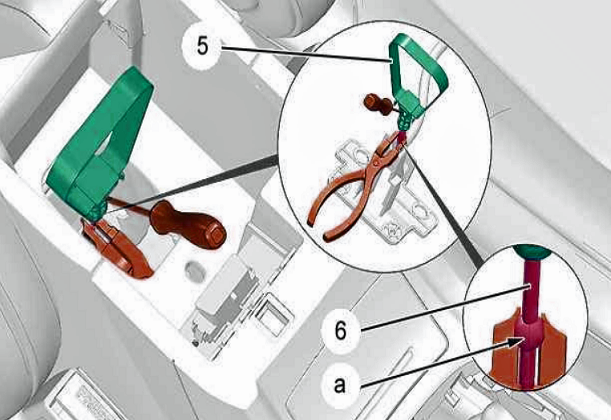

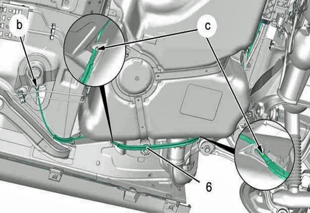

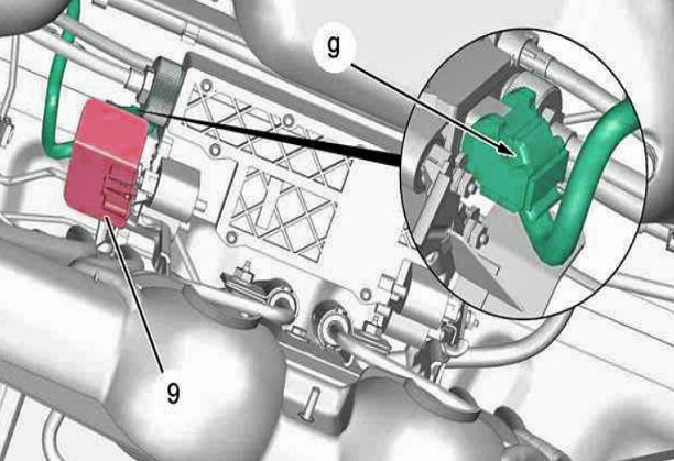

C5 X7 Electronic Parking Brake Removal Procedure
Disconnect the battery.
BSI Rest / Battery Disconnect / Reconnect Procedure
Refitting
Refit: The electric secondary brake unit (11).
Tighten the nuts (10) to 0,8 ± 0,2 daN.m.
Connect the connector (at "g").
Refit the protector (9).
CAUTION: Respect the routing of the manual unlock cable (6) and of the parking brake cables (7).
On each side:
Engage the electrically controlled parking brake manual unlock cable (6) in its housing (at "b").
Immobilise the electrically controlled parking brake manual unlock cable (6) (at "a"); Using universal pliers .
Couple that handle the (5) to the electrically controlled parking brake manual unlock cable (6).
Refit: The underbody protectors (8) and (7).
Return the vehicle to its wheels.
Refit:
Refit: The glove box (1).
Reconnect the battery (follow reconnection procedure).
CAUTION: Before carrying out the handbrake calibration procedure, ensure that the ferrules of the hand brake cables (7) are correctly positioned in the caliper levers (at "d").
- Slacken the parking brake.
- Raise and support the vehicle, with the rear wheels hanging free.
- Place the electric parking brake in the removal position; Using a diagnostic tool.
Remove the glove box (1). Unclip: The gear lever gaiter (2). Remove:
| Pull the handle (5). Immobilise the electrically controlled parking brake manual unlock cable (6) (at "a"); Using universal pliers . Uncouple the handle (5) from the electric parking brake manual release cable (6); By means of a screwdriver. |
Remove the under body protections (7), (8). | Extract the electrically controlled parking brake manual unlock cable (6) from its housing (at "b"). Unclip the electrically controlled parking brake manual unlock cable (6) from the fuel tank (at "c"). |
On each side:
| Remove the protector (9). Disconnect the connector (at "g"). |
Intentionally Blank | |
Unscrew the nuts (10). Remove: The electric secondary brake unit (11). | Intentionally Blank |
