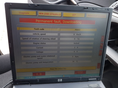

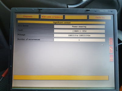

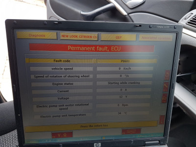

Ok, slightly worrying looking at those screenshots:
P0601 is basically an ECU fault - either the EEPROM has failed or it cannot read the fault codes stored in the ECU - and in this case it is the Power Steering ECU - so it cannot tell us the specific fault codes stored within it.
On the P0602, this tells us that there has been a downloading error to the ECU - now that is the concerning one as this should only occur if the ECU has had to have it's software updated or the configuration has failed during a telecoding session and the data has not been written back to the ECU properly - in other words it has become corrupt. I have to ask whether you have tried to use any 'automatic configuration options? Never advised with a clone unit.
I would check the connections to the power steering pump - clean the connectors and check the pins. So you have 2 faults - a leak and a communication issue with the power steering pump ECU.

Definitely not done any automatic settings. Wouldn't know how.
The faults were on one day when I came back to it.
Only just got lexia working a few days ago.
If I recall when doing the power steering codes. It can't recognise it properly.

I would make power connections my priority, 6volts is a big red flag.

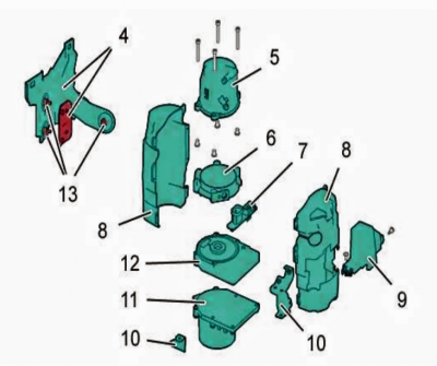

As far as the Power Steering pump itself goes, here are the components and the electrical connections, should you want to test them. Are you getting any power assistance from the steering?
(4): Electropump support
(5): Hydraulic fluid reservoir
(6): Manifold
(7): Connectors
(8): Acoustic soundproofing half-cowling
(9): Connector protective cover
(10): Connector protector fixing plate
(11): Electric motor
(12): Electropump assembly ECU (2 electronic cards and 2 temperature sensors)
(13): Electropump assembly filter elements
Power connector " a" :
Terminal 1 : + 12 V
Terminal 2 : Earth
Connector "b" :
Terminal 1 : CAN
Terminal 2 : CAN
Terminal 3 : NC
Terminal 4 : CAN
Terminal 5 : CAN
Terminal 6 : NC
Terminal 7 : Ignition+
Terminal 8 : Line
Terminal 9 : NC

Yes, well spotted Mike, the voltage for the power steering at normal operation should be 13.5V - The Power Steering has a small reservoir of LDS fluid within the pump. If there is a failure in the electronic cards in the pump (ECU) it goes into backup mode to provide some assistance.

Back to this again whilst looking at the front.
Connector a) in the above diagram.
Only has one wire.
Purple.
Right or wrong.
Looked at everything.
Took all off and cleaned and put back on.
Just need to read code to see if it will delete now.

It shouldn't work with only one wire - it will need both to make the circuit work. Are you saying both pins are there, but one of the wires has been pulled out?
