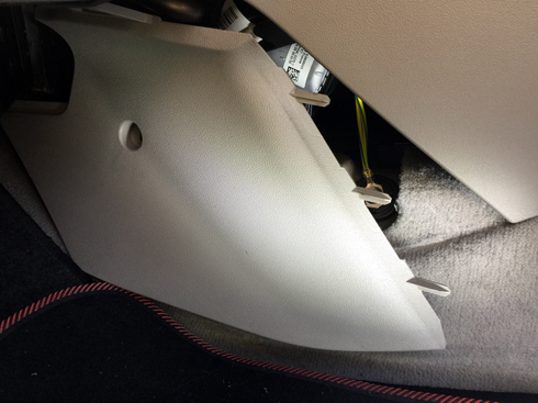

First of all there are 2 plastic screws under the passenger side glove box at the front that need to be turned 90°.
A - Trim Screws Close Up
B - Unfastening the Passenger Trim
C - Trim Clip shown to the Right
E - Lever Out the Footwell Light
On the right edge of the trim, you will see a snap connector - push this in and the trim will loosen. Be careful as the footwell passenger light (if fitted) will be attached.Using the Flat Head screwdriver, gently push in the small plastic lug of the Footwell Light and lever it out so that you can access the plug.

D - Underside of the removed Trim
H - Pollen Filter Clip
Carefully remove to one sideWith the top trim removed, you can now see the Pollen Filter cover through the exposed recess.

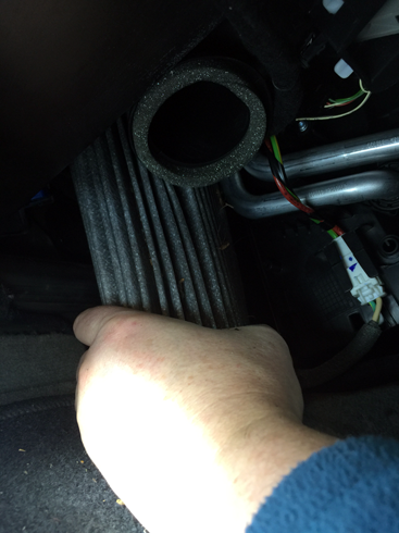

J4 -  Ease Out Filter
J6 - Wrap and Pull
J6 - Wrap and Pull
J7 - Heater Matrix
J7 - Heater Matrix
As You pull out the filter, try and roll it, whilst pulling gently as there isn't a lot of room to pull it out directly.Whilst we are here - this is the Heater Matrix Location!

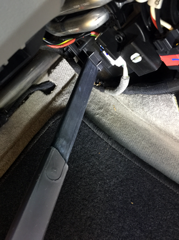

Out with the big guns - time to hoover out all the rubbish.'Bugs be Gone' - This flexible crevice tool is great for getting in at angles.
K6 - Dyson Bendy Pipe
L - Air Con Bomb Time
We bought the car kit with our Dyson Animal - it has a bendy crevice tool - great for getting into the recess at an angle.Now for the Air System Clean (whilst the filter is out)

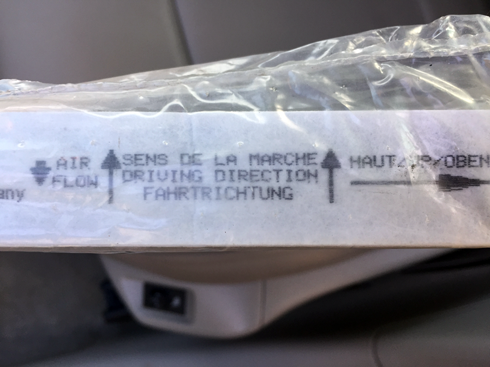

Look at the notes or instruction either printed on the filter or on the instructions - the filter is designed to operate only one way and should be positioned so that the air flows correctly from the front of the car to the back of the car in the direction of the air flow as per the arrows:

M3 - Direction Important
Arrows indicate Air Flow and Driving Direction on some filters.
