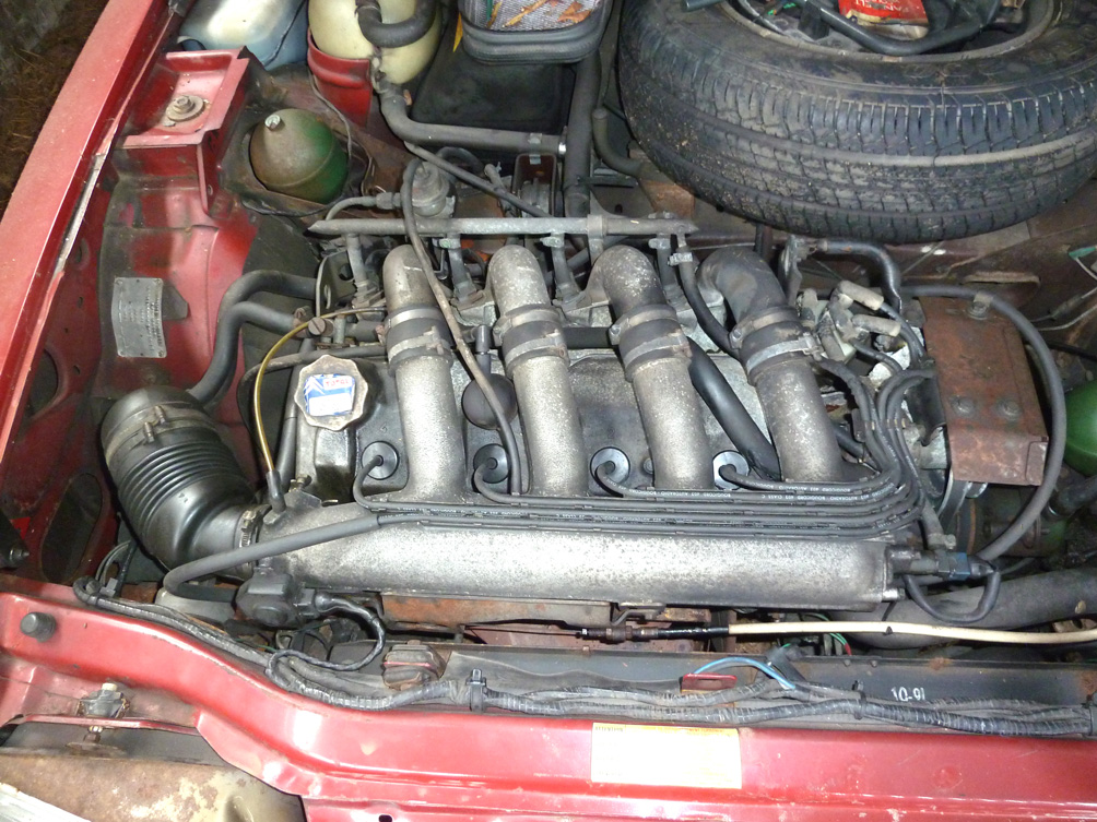

Following Patrick Ruggs call for all CXs to return to the road for next years 40th anniversary, some may remember I have a 1983 CX 2400 I/E Auto saloon, a couple of years ago I was having trouble starting it because sometimes you used to have to wiggle the wiring behind the n-s headlight to get it to start. One day it would not start and after much churning it spat back and caught fire. After the panic to get it out the damage was minimal with a bit of burning to the plug leads, which I have replaced with new ones and a scorched bonnet that was rusty anyway and I have a replacement.
The problem is I need to load it onto a trailer to take it somewhere to make it start and MOT it for me. The car is sat down in the slopping corner of a dirt floor barn with even rougher ground outside.
Is there a way to pump up the suspension using a say a battery drill so I can tow it out and load it onto a trailer?
After the fire showing minimum damage.
