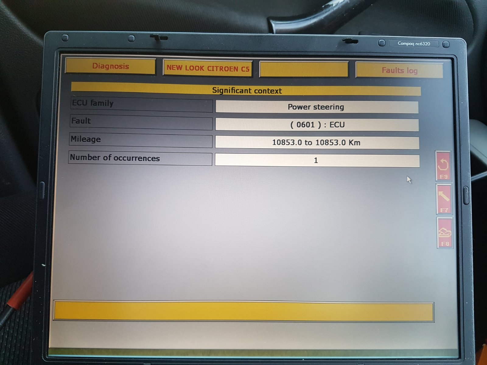

Codes still remain.
On the codes when read it does say the pump isn't turning.
Also got 0601 off the ecu.

Ok, slightly worrying looking at those screenshots:
P0601 is basically an ECU fault - either the EEPROM has failed or it cannot read the fault codes stored in the ECU - and in this case it is the Power Steering ECU - so it cannot tell us the specific fault codes stored within it.
On the P0602, this tells us that there has been a downloading error to the ECU - now that is the concerning one as this should only occur if the ECU has had to have it's software updated or the configuration has failed during a telecoding session and the data has not been written back to the ECU properly - in other words it has become corrupt. I have to ask whether you have tried to use any 'automatic configuration options? Never advised with a clone unit.
I would check the connections to the power steering pump - clean the connectors and check the pins. So you have 2 faults - a leak and a communication issue with the power steering pump ECU.
I can only suggest at this point that you try and get it to a dealer and make them aware of the fault codes you have (keep the printouts or screen shots) and see if they can A) determine if the ECU has in internal fault - they may be able to download the software to it again if they can communicate with it - and they may be able to assist with the leak.
