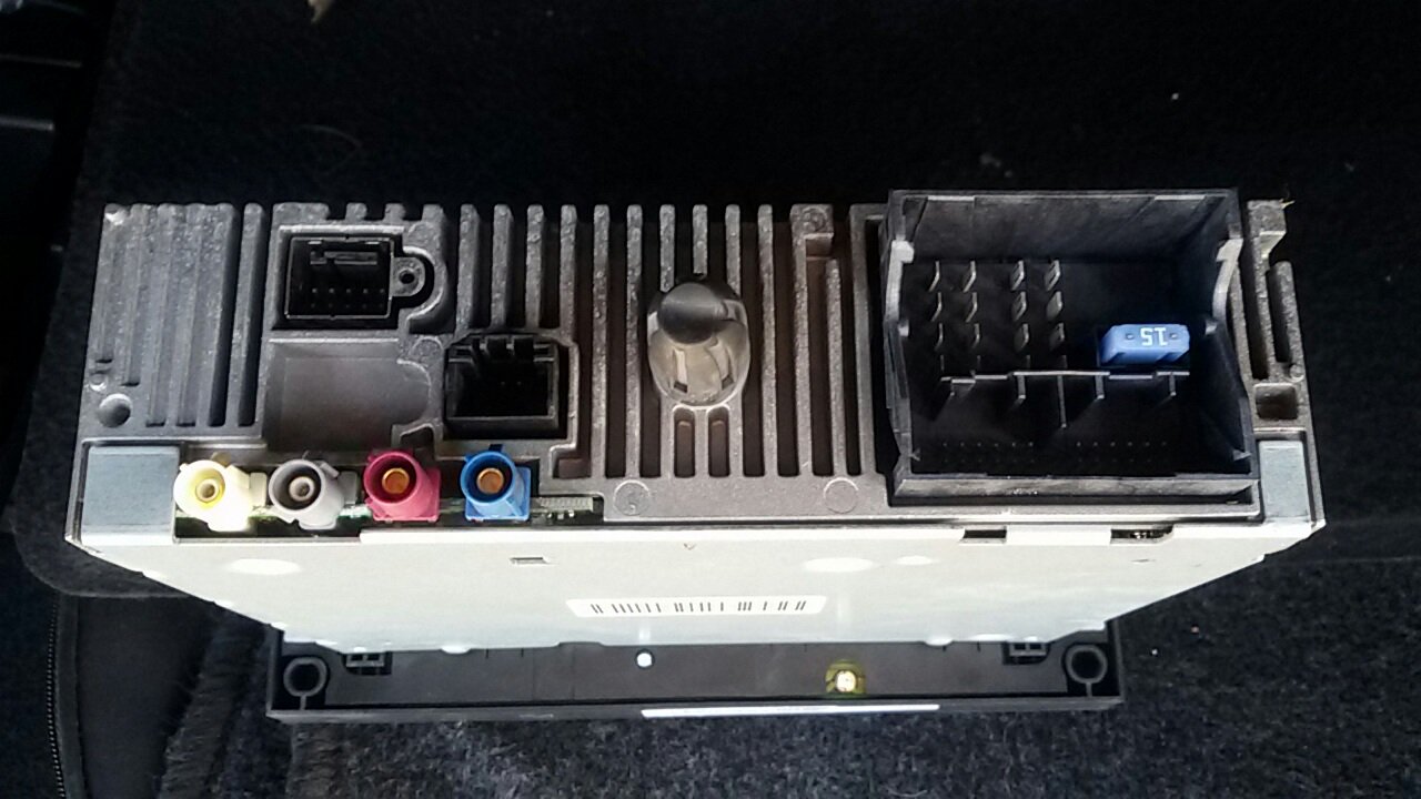

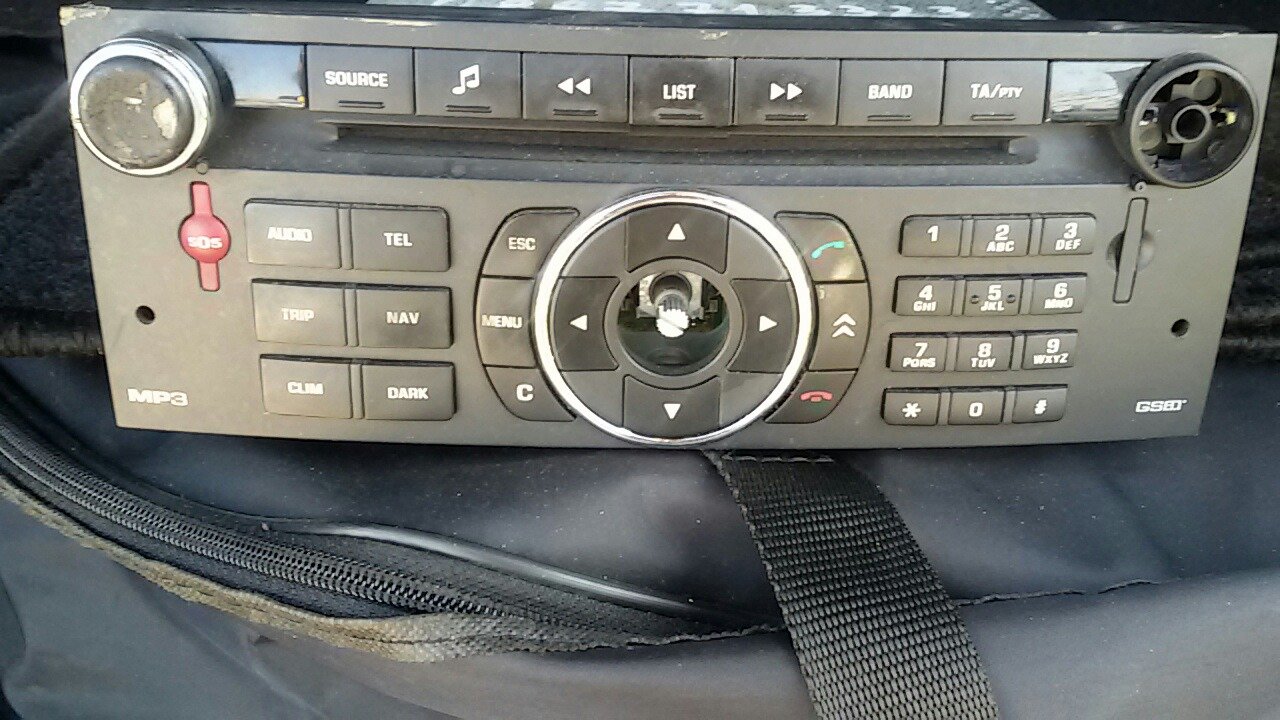

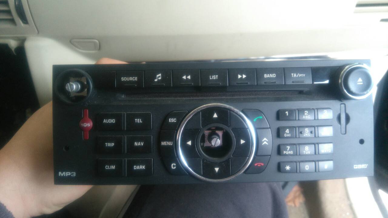

I find device.Citroen C6 but i dont know is rt4.the seler tell me it is rt3 but look like rt 4.i upload picture to help me what is is.

the quickest way to tell the difference between RT3 and RT$ is, RT3 holds the maps on a CD, whilst RT4 has a HHD for music and maps

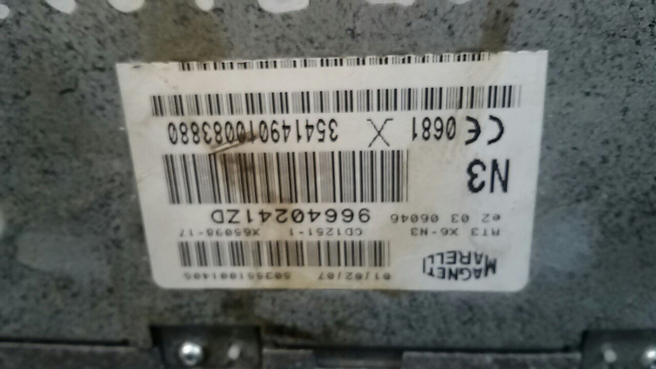

The label says it's an RT3 X6 N3

according to my tame expert, this is an RT3 Evolution which is essentially the RT4

If it has fibre optic then RT3 also only antenna socket plus two fakra for GPS GSM
The evolution has a row of 4 fakra connectors different colours, and a 30gb
Steve

Bibiqn
Posts: 25
Joined: 23 Apr 2018, 19:06
Location: Ruse.bulgaria
My Cars: C4 picasso 1.6 hdi
Re: Magneti Marelli rt 4 problem
Post by Bibiqn »
Yes and i thing so.if have 4 colours conector is rt 4.but ther seller say me its rt3.i m confused.

Basically it's RT4

Guys this is probably NOT compatible with the C4 Picasso. That is an older system. The RT4 that went into the C4 Picasso is similar to the RT4 used in the early X7.
